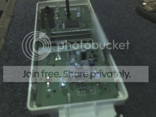

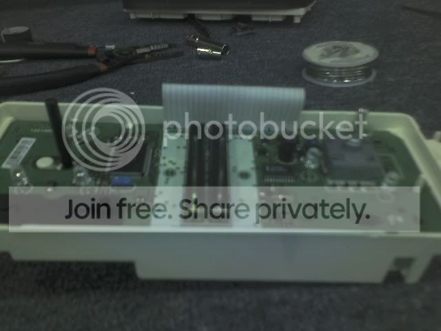

you have to make sure that the LEDs are either 12v ones (with built in resistor) or hae the external resistors that HAVE to be hooked up. ALso you need to make sure of the direction of them as the D stands for diode which means they are a one way electronic valve.
I did it, it wasnt fun

What am I looking at?
