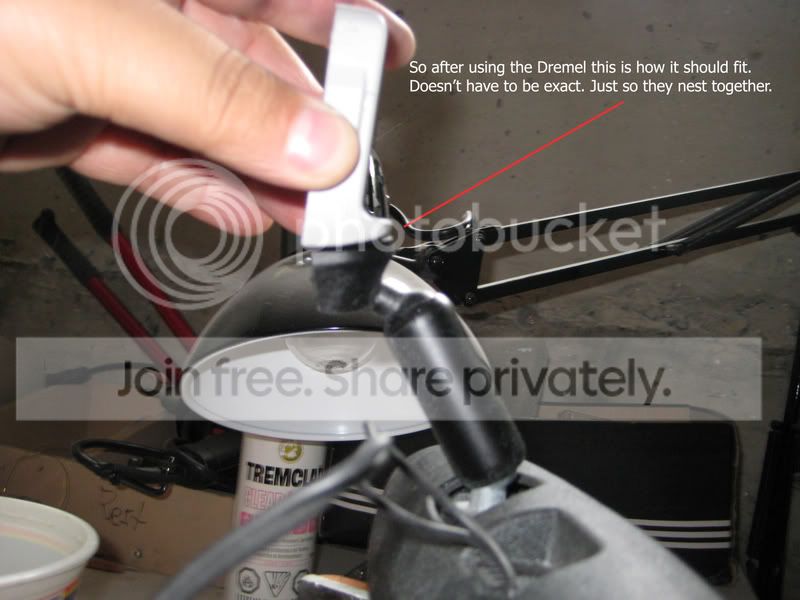

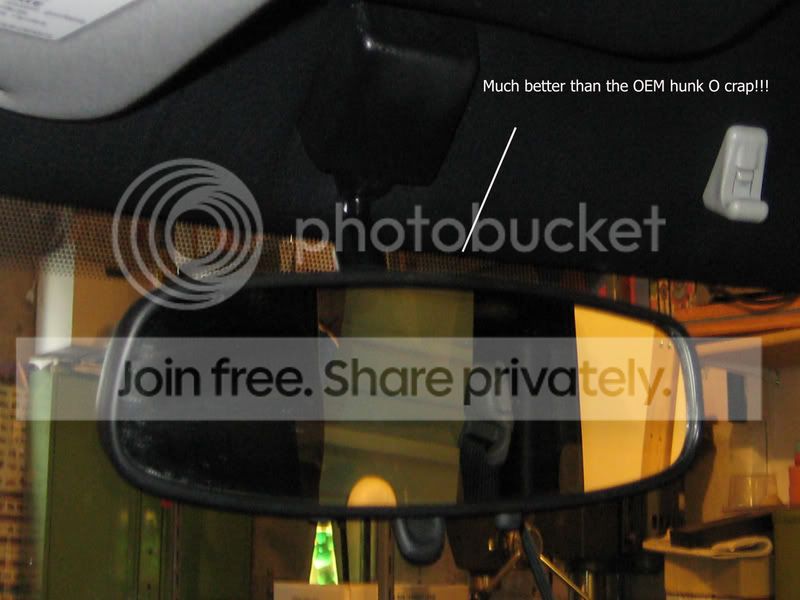

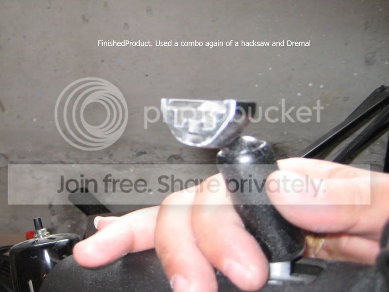

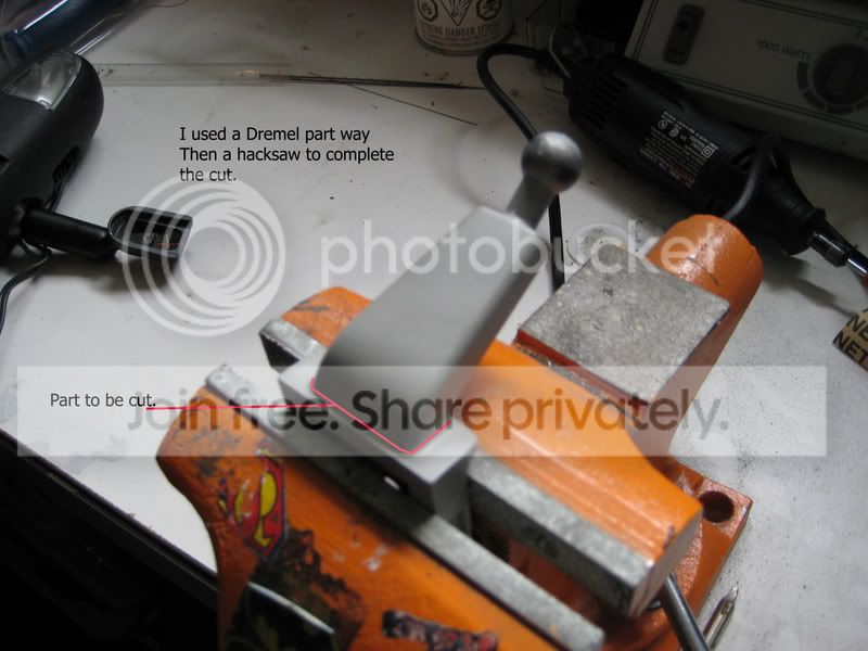

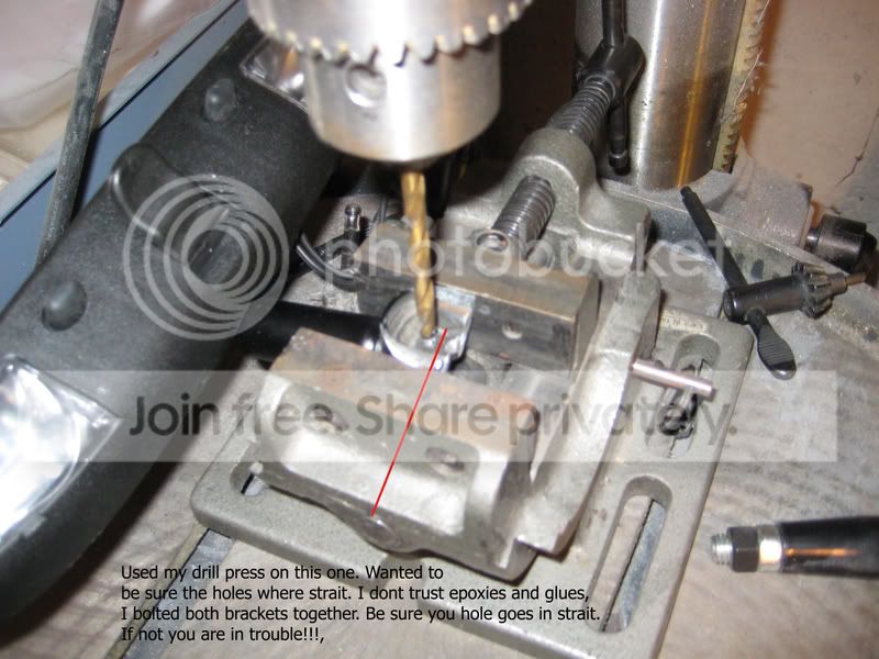

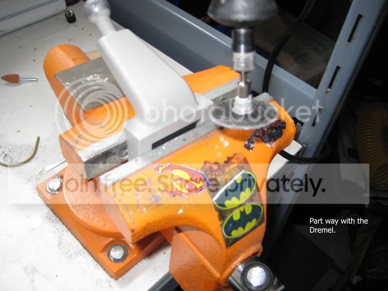

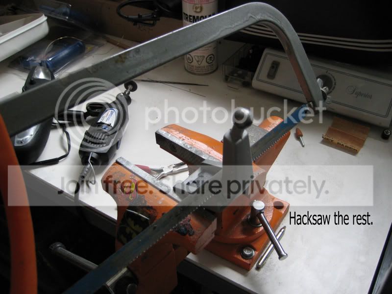

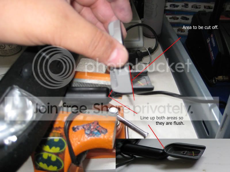

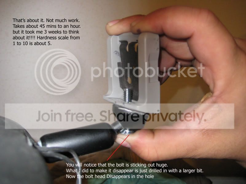

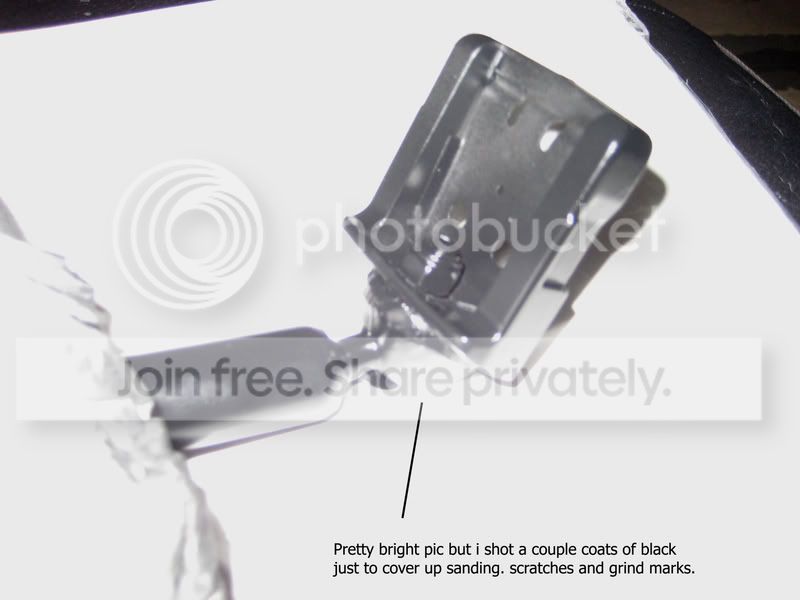

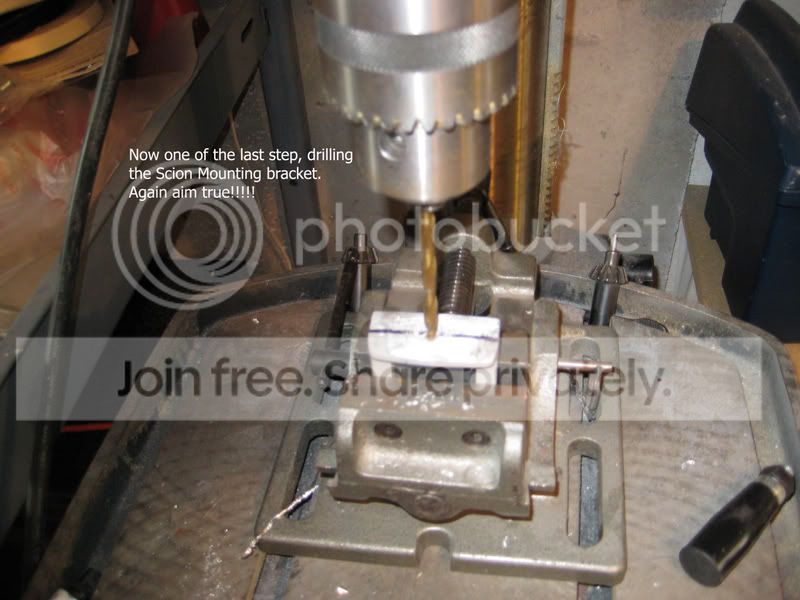

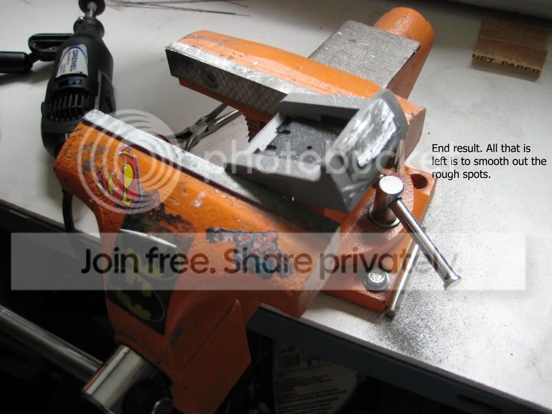

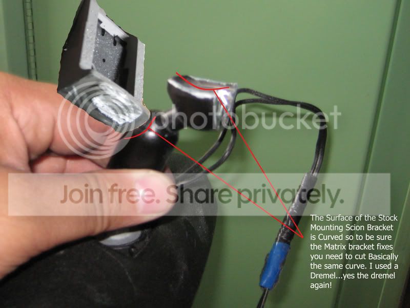

Matrix Mirror Swap Using OEM Mirror Bracket
Tools I used:
Dremel
Hacksaw
Vices (table vice and MY drill press vice)
Metal FilesSandpaper
Kyrlon Fusion (For plastic bracket cover)
2006 Matrix rear view mirror
(Wanted it for the read lights and anything is better than the one already in there!!)
Nut and Bolt
Mod Time: 1hour.
Hardness scale1-easy, 10 Hella hard) 5

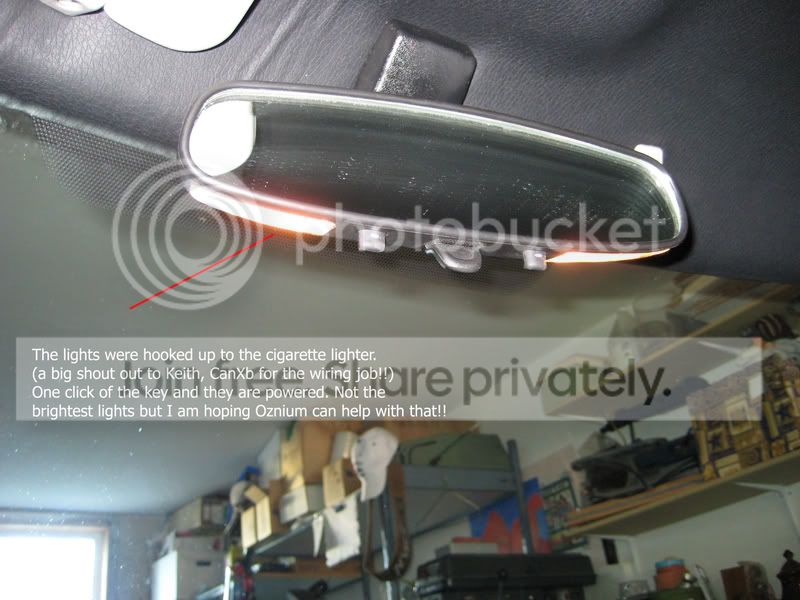

I am having a fellow Scion Brother (CanXb) help me with the wiring of the lights. I will try and DIY that as well pending time.

Awesome pics! What lights need to be wired up? Does the Matrix mirror have lights?
