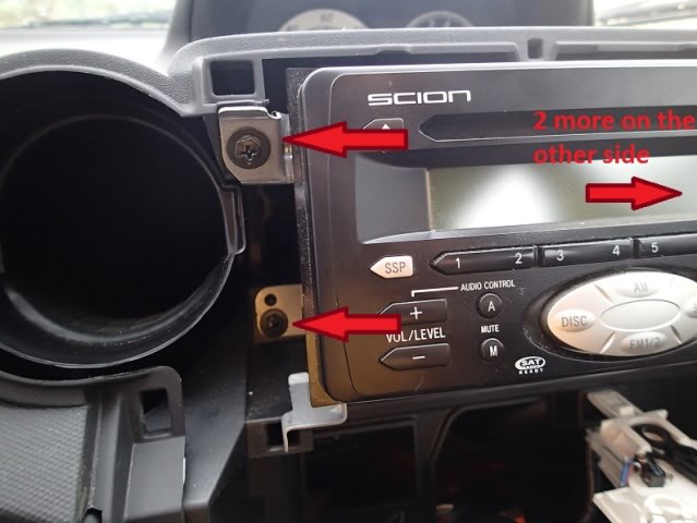

Remove the 4 bolts that hold the radio in place:

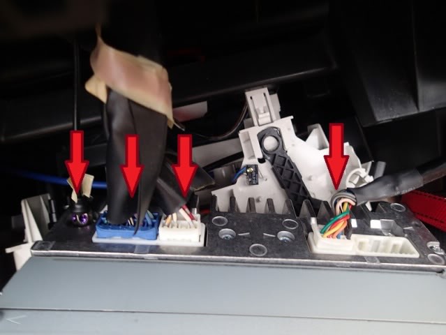

Pull the radio and unplug the wire harnesses and the antenna wire:
