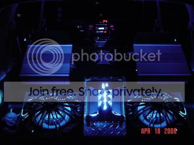

I biult this box for my Xb but had to take it out. It put out so much sound that my rear quarter panels were flexing about 3/4" in and out. If you biuld this one make sure you use Pro quality sound blocker or your box will sound like a beer can. This is the one I biult insted.
