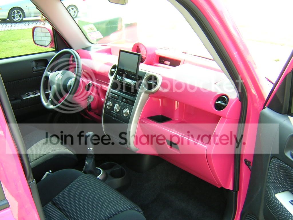

Originally Posted by NewMexicoxBPhatBoy
mm. there is someone on here you can get ahold of, im not to sure of his name, but he has a 2-tone xB, its the top PINK and the bottom BLACK... and his entire dash is painted pink.. top to bottom.. so i dont know if you know who im talking about, but if you do., maybe you can search for him, hope this helps...
My wife has the pink one he is talking about, i did it in 04 and early 06 it started letting go. I have worked in paint shops for over 12 years and properly prepped it and baked it multiple times to get the mold release agents out but it still let go. Once show season was over i started chipping the cracks away and it was black on the backside of the paint, not white like the sealer we used. It almost seems like a top layer of plastic is chipping off but it's only in the areas where the harsh texas sun gets it, the bottom half is fine.
