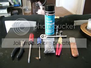

Tools Needed:
Side Cutter, Flat head & Philips head screw driver. hog rings, hog ring pliers, spray glue, Tuck tool, 14mm wrench, 14mm socket, 12mm socket. razor blades

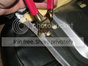

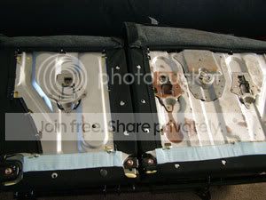

First rear seat bench flip over and you'll see this:
Look for the Hog rings they look like this:
Take them all off, a quick flip of the rist with your side cutters will do the trick.

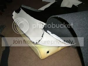

Now flip back over and slowly take off fabric.
Now get new cover flip it inside out. Spray glue liberally on the foam and the back of new leather. Let tack up then starting in the middle line up the seams and smooth down wroking to sides.

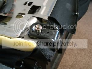

Then remove the mounting bracket there are 4 bolts like this:
Flip back and expose the hog rings and remove all hog rings.

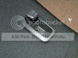

Take off the foam and remove the headrest mounts and release pull. The release pull unscrews and the headrest mounts have squeeze tabs. Pay attention to how these come off, so you put them back on correctly. The center headrest has smaller holes also the placement of the ones with the adjustment lock.

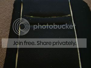

Now the rear seat backs are gluded on very well you will pull off foam if you try to remove, so take a razor blade and cut the seams around the side and on the seat leaving it looking like this:
You just need to leave the front portion of the fabric on (where it's glued). Cut out the seams on the front of the seat so the new cover seams can get in to the seat.

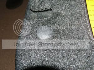

Put the mounting bracket back on and your reeady to reinstal the back seat. I did the headrests last after they were back in the car. Your gonna have to cut holes in your brand new leather to reinstal the head rests. Just cut enough to expose the metal shaft that the plugs go into like this:

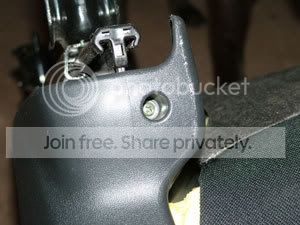

Take off the plastic on the sides and hanger thing on the back.

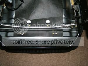

Flip seat over and remove all hog rings on bottom.
Then pull throughthe back and pull off the front of the cover from the underside, watch out this metal is SHARP!! The cover is attached kinda like weather striping ini the front. Now just pull cover up and remove hog rings.

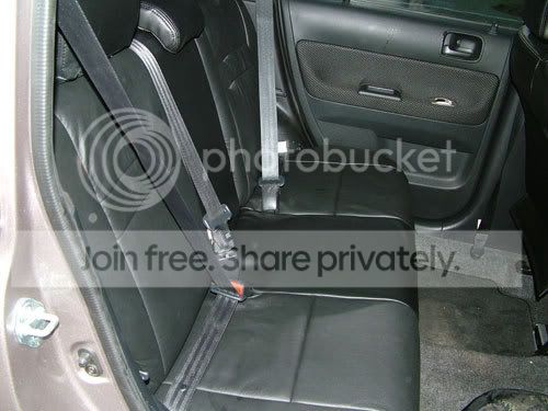

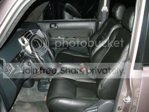

Finished Product:
