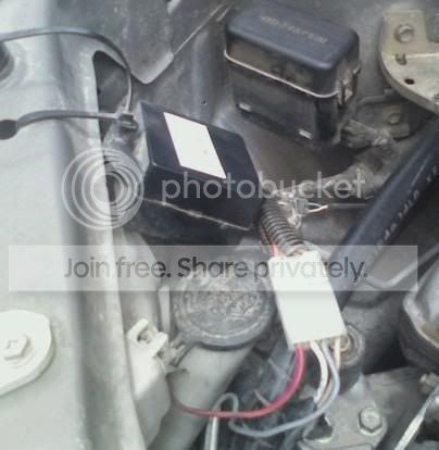

Hey everyone, I need some advice or tips on how to remove this system. i bought my Scion xB back in Nov. 2004 and I purchase the Platinum Package which came with this anti-theft system. where I have to turn on my right signal light to start the car.
It's connected to the right signal light, starter and i think the ignition but idk. Well lately I have been getting some problems with it, like i gotta keep shaking it every time I start my ride. it has a new starter, battery, and alt, ignition is fine. this is the only problem I can think of.
Thanx to everyone who posts.
Here's a picture on how it looks like:

trace down and disconnect all wires?
i am sure that somone here should have the install instructions for that system, if so, do the install in reverse.

That unit is basically interrupting the starter wire at the starter, trace the wires to the starter and bypass the starter kill by reconnecting the cut starter wire.
If you're in the So Cal area I can help you eliminate the device. You can PM me. I work at a So Cal Toyota dealership.
