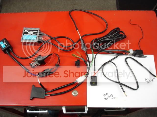

Right now for the life of me I can't figure out how to give this kit what is wants (no voltage with the switch off, the factory condition of the xb is all three headlight prongs are 12v with car off and switch off) Here are the pics

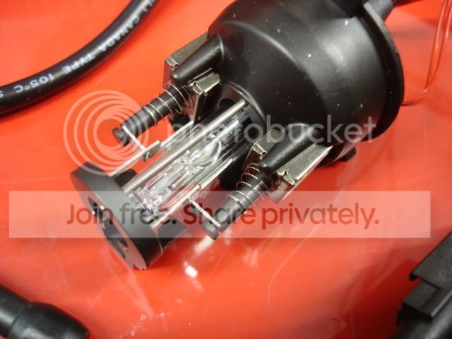

This is the high low H4 bulb
