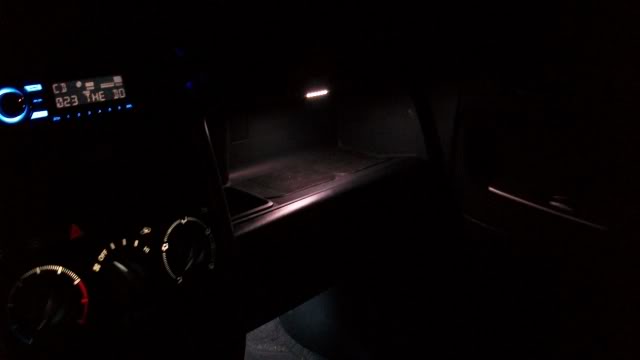

I have LED strips n such and am soldering all the +'s under the left front pillar area and all the negatives on the right, then running a main wire for +/- to the terminals on the dome light bulb.
Here's an old poor quality pic:

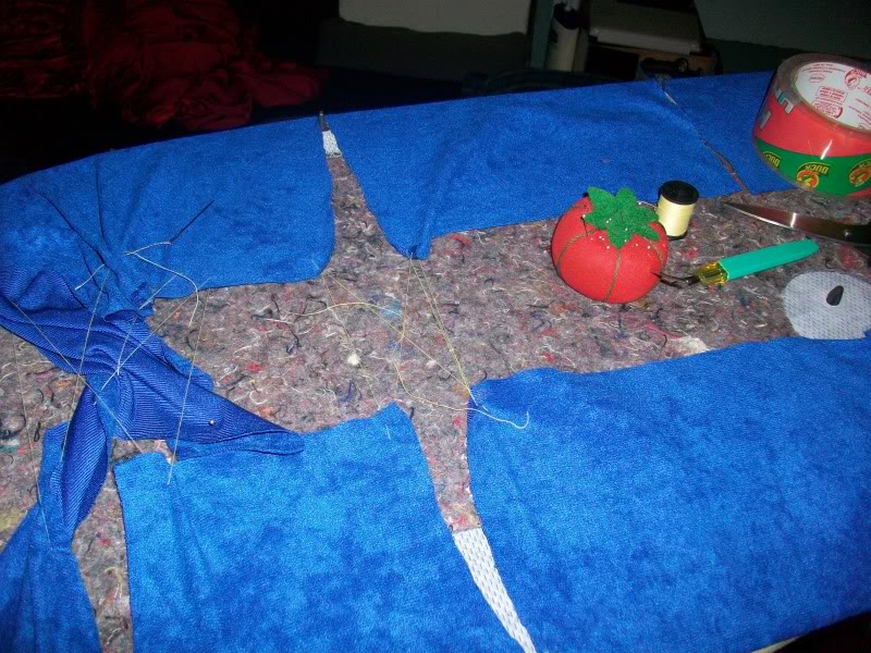

Here's my back hatch cover, I haven't sewed in a while and never used an iron before!
I think it looks really good. Hopefully I can press it in with the cloth around the underside where the plastic push pins go.

I superglued the pins on before I put the fabric on top of it. That way they stayed in place while I sewed the fabric together on the back side. Then I pressed the panel on.
No glue use at all, the fabric can be pulled tight enough against itself to make it wrinkle free.

It's quite a mess, I took one when I first started.
The round areas are a bit more difficult. I cut the corner into three sections, and twisted each piece of cloth and pulled it tight. I did this on either side and sewed them together, making sure to pull tightly on any slack.

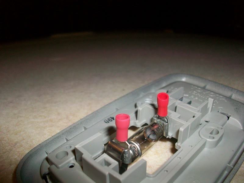

As for adding lights to the dome light, to get the unlock and fade effects, I ripped everything I had out and I'm redoing it and soldering as many connections along the way so I can sleep at night.
To splice into the dome terminals, isn't easy to do neatly. I wanted to do this,
but there isn't enough clearance between the dome and roof. I've seen a guy twist the wire around the hole in each terminal and solder that. He took a lot of flak for it, but it certainly works.
