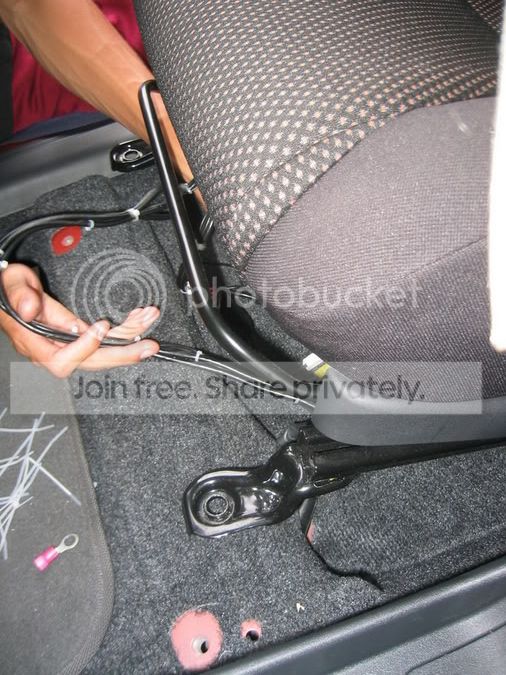

Default just a couple quick pics from my install
still not working yet
thats the antenna

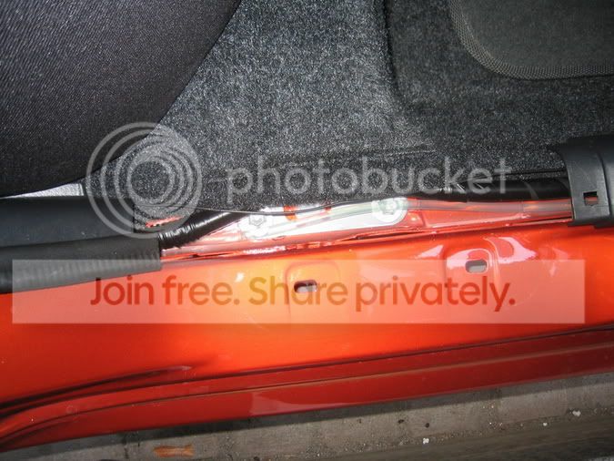

Back seat with the sill removed...

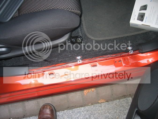

Front Seat with sill removed...

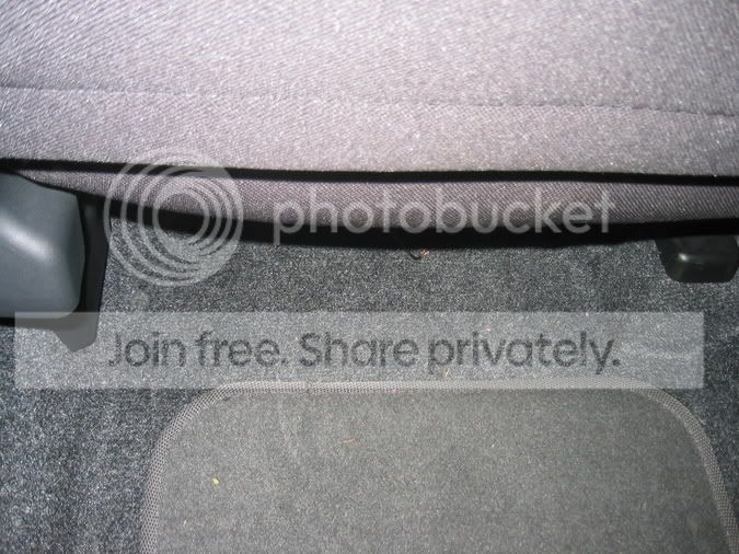

Front Seat with sill on...

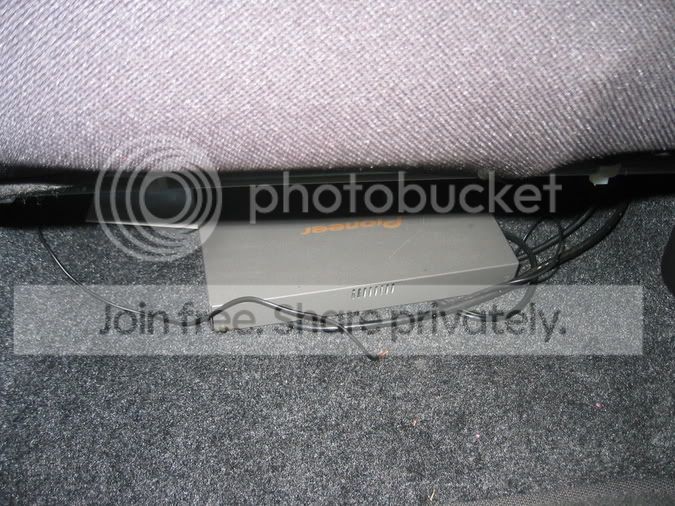

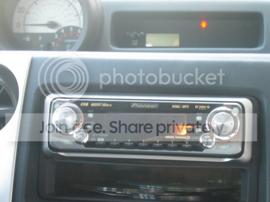

Couple Pics of the XM tuner unit...under front passenger seat it's out of sight unless you look under it...

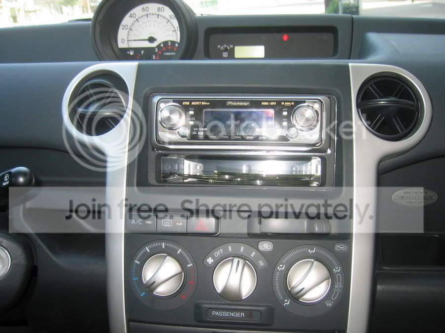

the head unit...
~wC

yeah no I know that oneslowxa and tried the reset button too...the issue is that I'm not geting anything on the head unit...it's as if the tuner box isn't even there...I wasn't able to do anything with it yesterday but I'm gonna go to a friends house tonight and he's gonna take a look at it...see if there is anything stupid I missed...

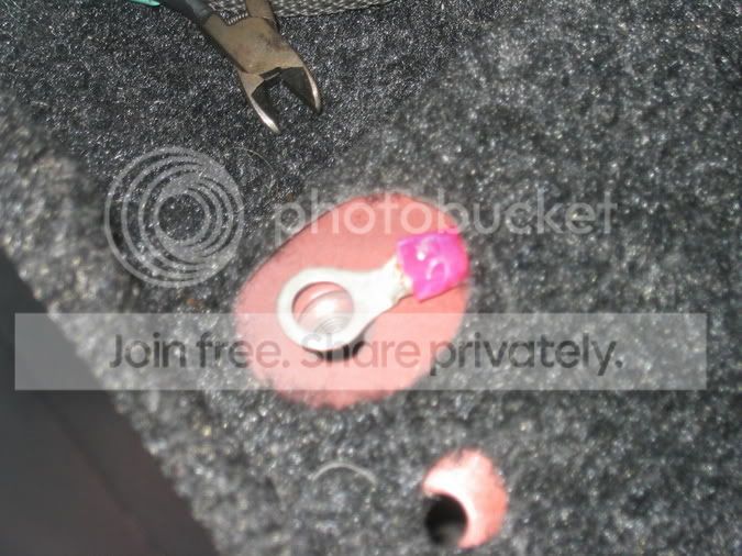

ok figured it out...I didn't have a good ground...so I remedied that problem this morning and I have my XM back! after a three month absense in my car....
I just thought I'd post a couple pics of the ground...I also cleaned up the install a lil running the wires under the carpet and such...
