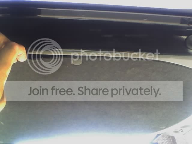

What is the best way to remove the tabs on the inside tailgate of the xB. I have noticed these same tabs on other areas of the car and I have had the darndest time getting them off. Is there some trick Im missing?

there is a tool that is made for this.
you can pick it up at pep-boys for about $4
its called a door trim remover, its in the "help" section.
its a must have for installers LOL takes the pain out of manual windows with jesus clips.

Im going to have to check this out. Cause I been jamming one side with a screw driver while trying to jam the other side with another screwdriver while using my teeth to pull it off. Ok well maybe minus the teeth part.

Ouch, don't use knives etc. use the right tool for the job. It's called a panel popper or door trim tool. If you're going to be doing a lot of work on your car, invest in some of the more commonly used tools (Pick tools, panel poppers, soldering iron, screwdriver set) if you have a Snap-On or MAC truck near by. Even just stop by a Sears and get Craftsman tools. It just makes me cringe when people tell me they used a kitchen knife, coat hanger, or a flathead screwdriver (for something other than a screw) on their car.

i'd hate to correct you, but i bought my pannel removal tool at pepboys. you can check autozone, advanced auto, stores like that.
snap-on/mac does sell them, but they're very expensive.
crutchfield even sells one,

I was able to find them at autozone after a bit of searching in the tool section. Maybe not all the stores have them or maybe the one you looked at was out?

just an FYI--the panel poppers shown in the pic above are much better than the one I got (at kragen). The one I got has a mostly V-like slot, and the metal is too thick at the tip to slide under the plugs. its V shape made it hard to push in the sides of the plugs, so a couple broke when I levered it.
try to get one like in the pic.
