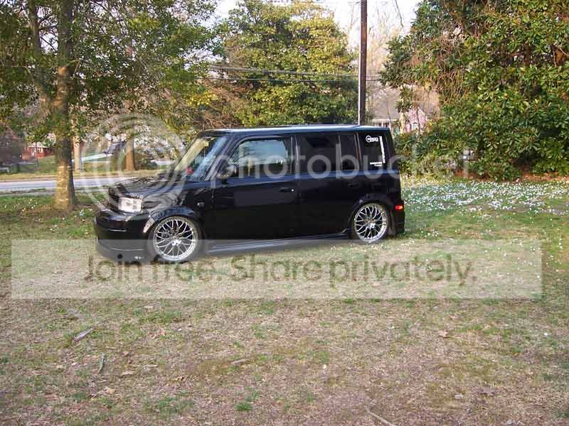

Apr 17, 2005 | 09:51 PM
BTW, Spider, is this pic real or is that photoshopped. It looks like its laid out, is it?
Reply
Apr 17, 2005 | 10:47 PM
That is a badly done chop. On 15's i doubt you'll be able to tuck much of the wheel,but with out the shocks you should tuck alot of tire. I can tuck all my tire and about an inch of rim in the back before i start to hit the top of the wheel well, on 18's. I have airlift bags in the back, but it should be about the same. I've never measured my bumper to ground, but with shorter shocks, my exhaust touches the ground. Best thing I could tell you is put it on jack stand that take the shocks loose and jack the axle up until you find whats hitting. I am sure sure it will be pretty obvious.
This is a crappy pic but this is how i sat with the kit just bolted on w/ stock shocks.
