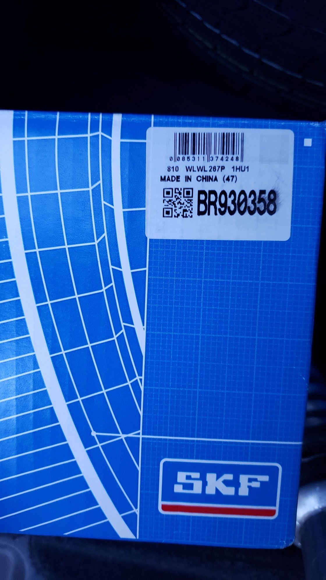

Bumping this thread as most xB owners will have to do this one day. I replaced both driver's side bearings and went with SKF. Drone went away and they've held up fine for the past 2+ yrs and ~20K miles. Neither of these parts were made
in Japan, but are very high quality. These were much cheaper than OEM, but I see a lot of aftermarket companies offering bearings for 1/3rd of the cost of Timken/SKF/NSK nowadays. My passenger side rear sounds like it's about to go.
Anyone have luck with brands like Detroit Axle, TRQ, Durago, etc? They seem to have decent reviews on Amazon.
