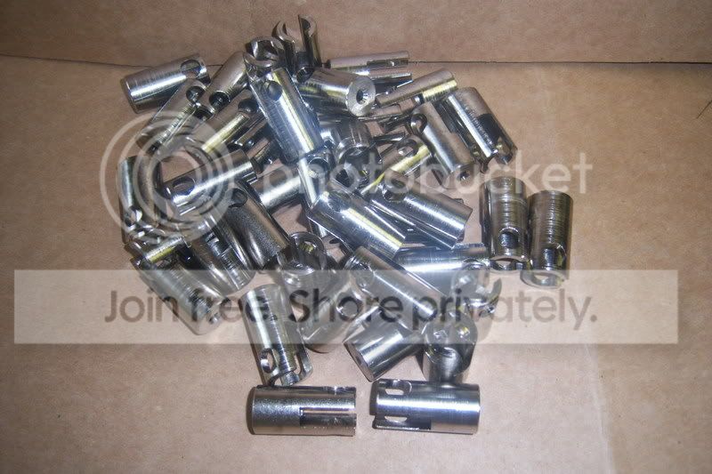

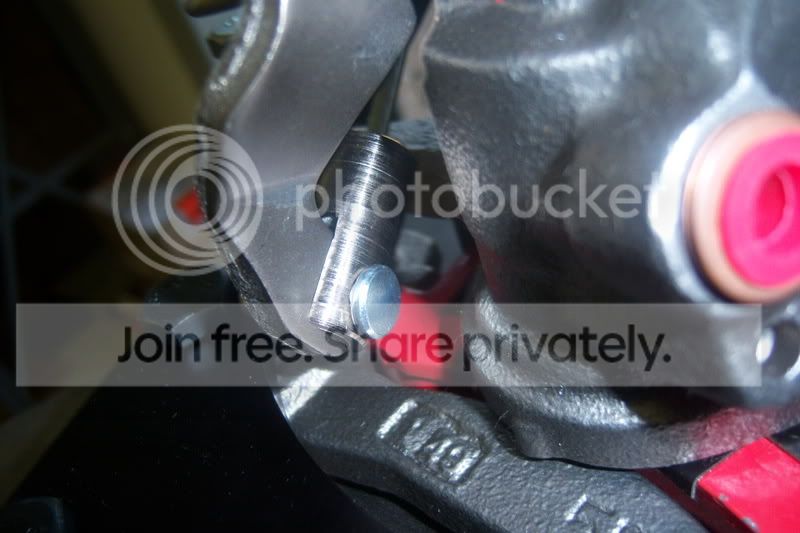

From: Tennessee

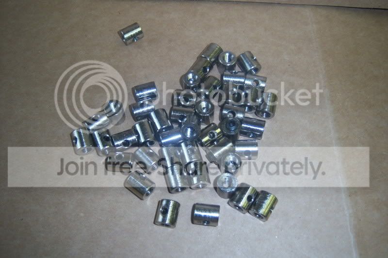

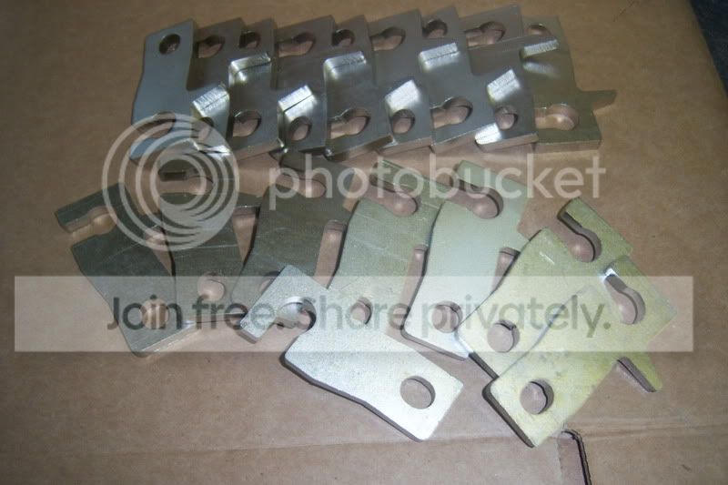

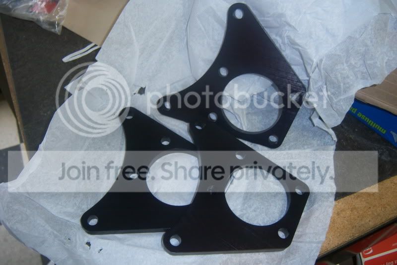

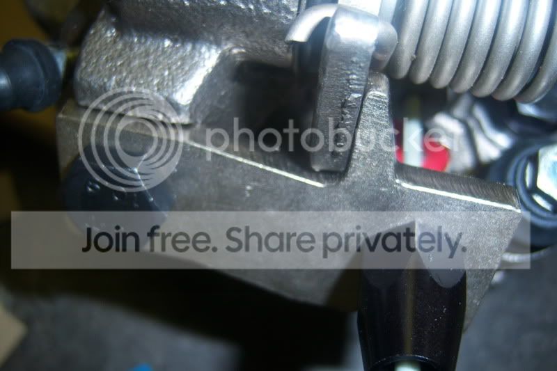

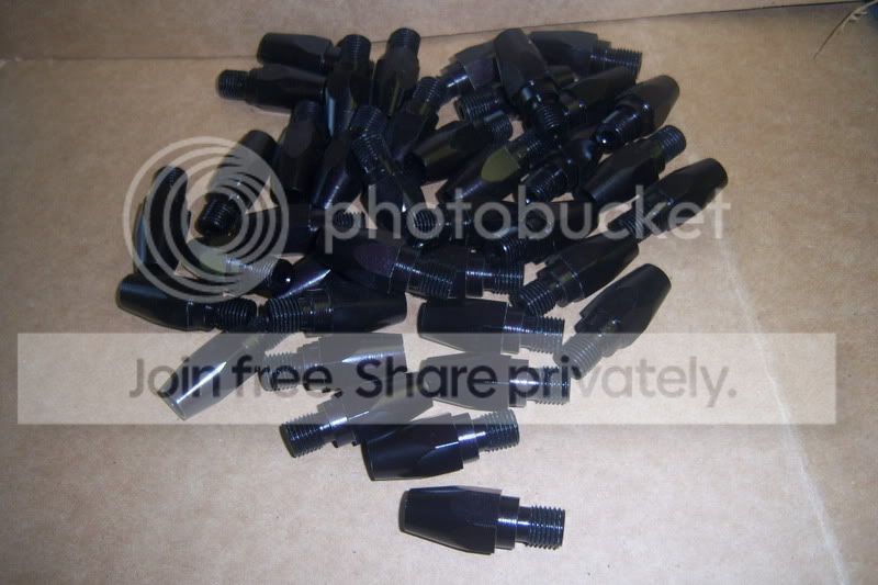

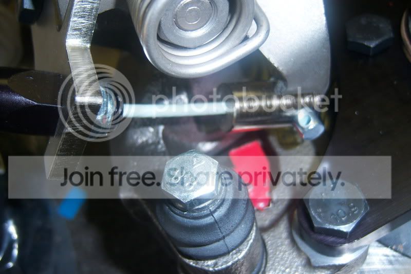

As anything in the aftermarket industry they are off road use only, for liability reasons.
Here are some more pictures of some more parts that showed up today.
New clevis, clevis pin, and cable end mount mounted:
Clevis' freshly nickel plated to prevent rusting:
And cable stops also nickel plated:
And the e-brake cable tabs that are no longer available in the US or Japan I had laser cut and nickel plated:
Black anodized caliper brackets and cable end mounts:
Hope you enjoy the pictures!
