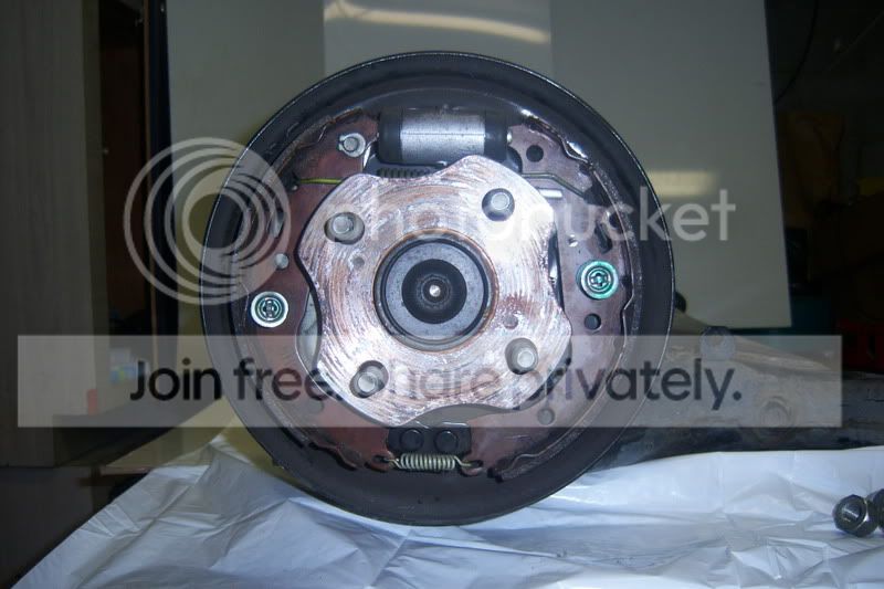

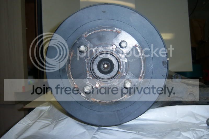

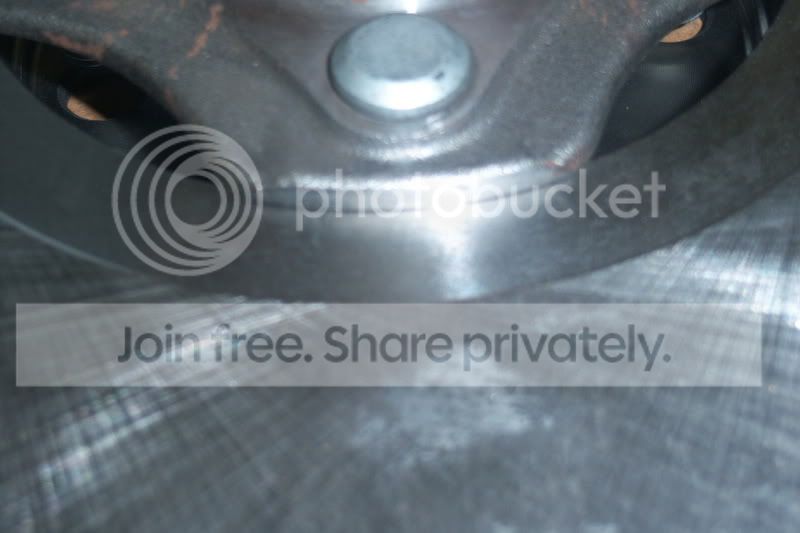

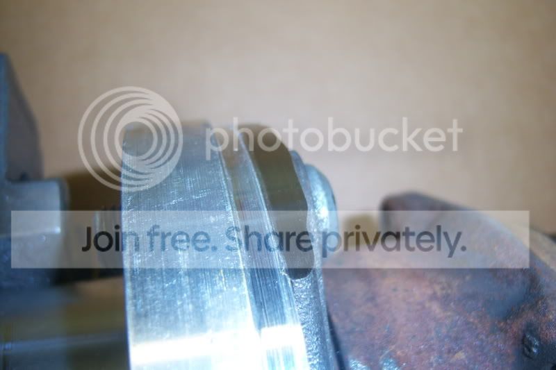

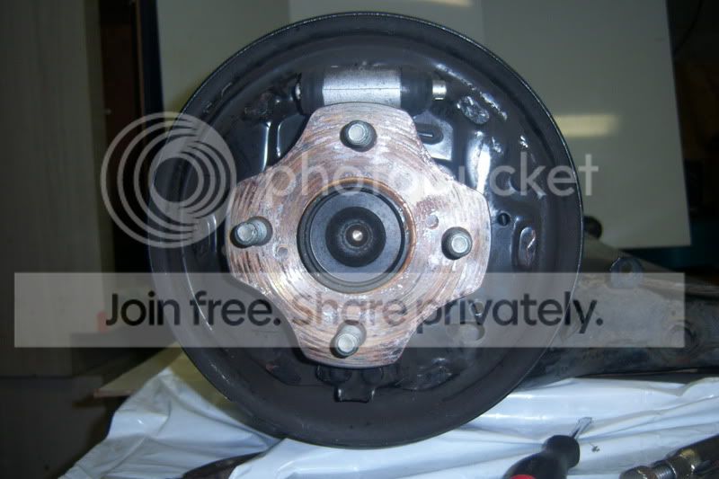

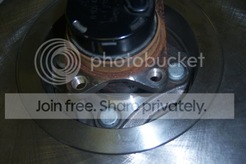

Ok, some have asked what has to be modified on the hub. Well, each spoke has to have .165 taken off of them to fit into the rotor. Here are a couple pictures I took last night of my hub getting machined. Before and after the .165 removed.
Before: This is on a fixture I made to mount the hubs in a lathe to turn them the same on each spoke.
And after it has been turned
And these two are before the hub is turned sitting on the rotor and after.
Before it's turned sitting on the rotor
And after, sitting in the hat after modifying it
Nothing to do with the rotors, but some CNC'd parts to do 20 conversions

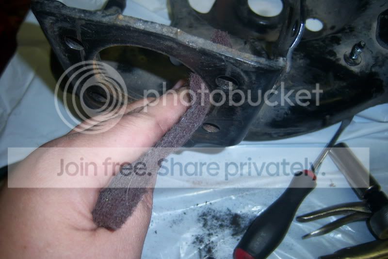

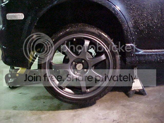

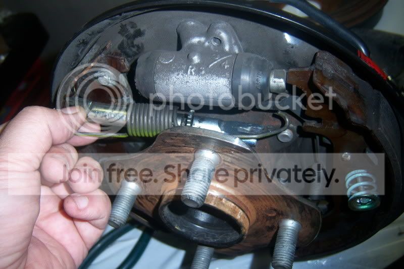

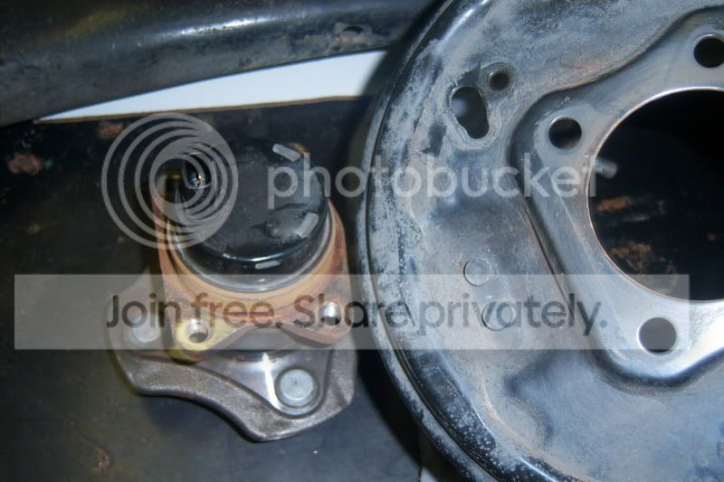

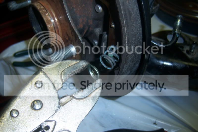

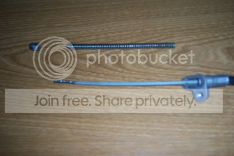

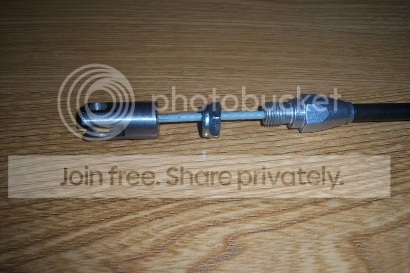

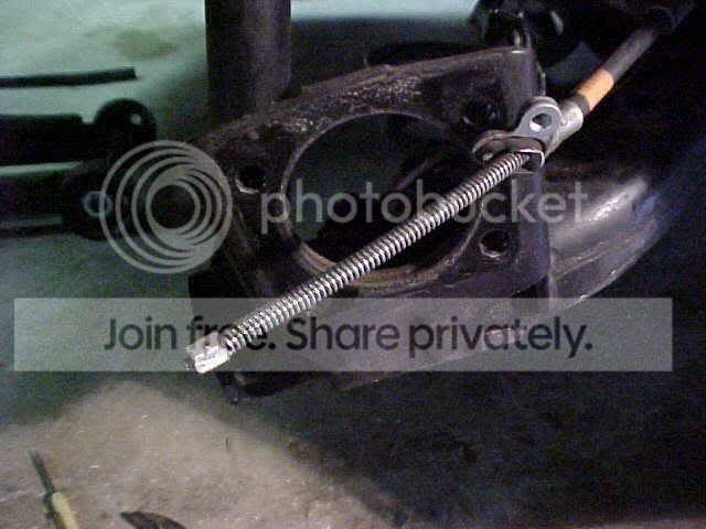

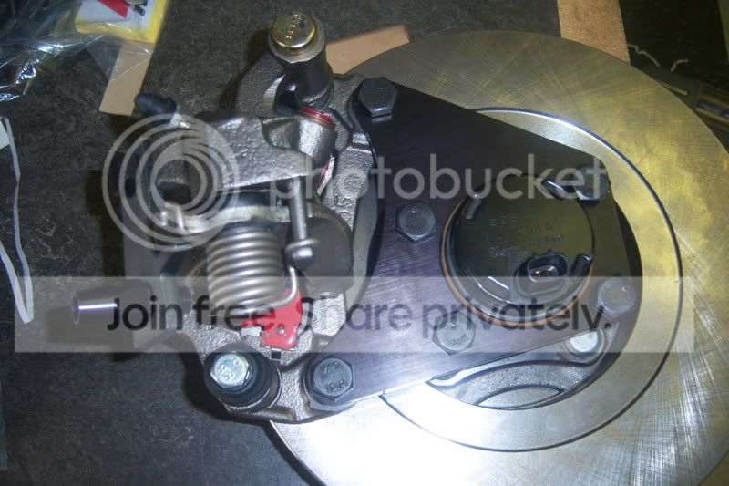

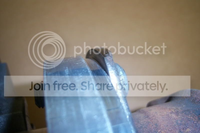

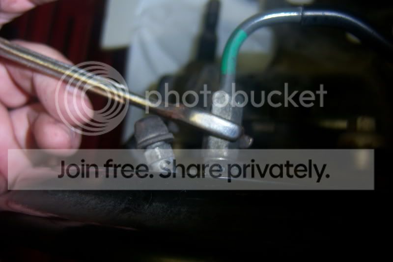

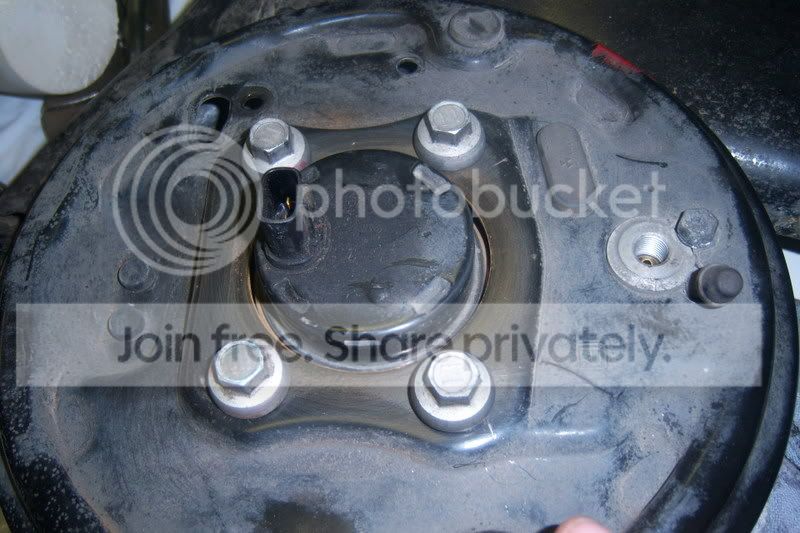

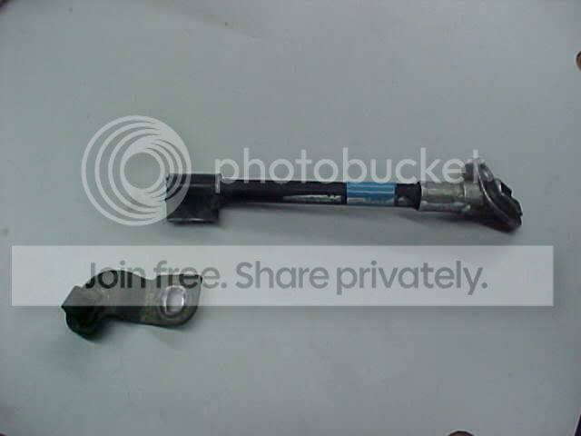

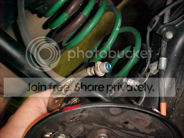

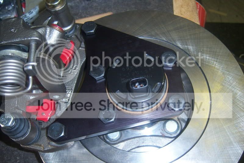

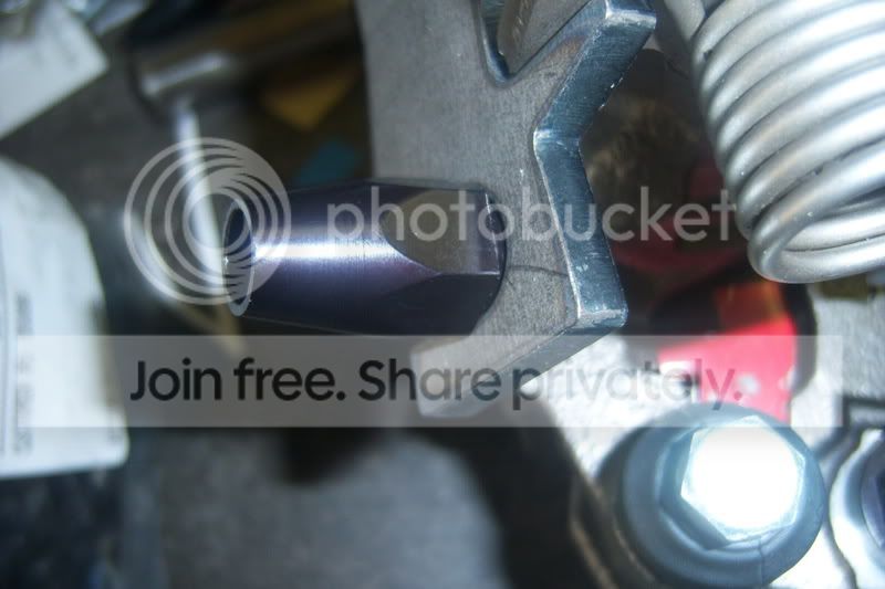

Ok here are a few more pictures of the actual install. I'm working on getting a PDF done of the installation, but I have been busy working on the conversion kits, so its taking a little longer than expected so here are some install pictures to see whats involved. Most of these pictures are on the workbench, so I could get some detail shots. These are just a few of them, and the ones on here towards the end are of the mock-up bracket. The new ones will be CNC'd and anodized black. This is just to give you all an idea of what is involved in the conversion.

Hey Alliance, I have a set of your rear spacers, are those going to work with the setup or is the new caliper braket going to take the place of said spacers?
Old May 8, 2008 | 03:24 AM
  #373
AllianceAutoSports's Avatar
Music City Scions
Posts: 186
From: Tennessee
Depends on what size spacers you have. I intended on making the caliper brackets 1/2", but after talking to Wilwood about the conversion they said I could use 1/4" or 3/8" and be fine. So the Caliper brackets will be 3/8". This will allow the camber guys to use the conversions also. Most of them are using the OTG 3/8" and the camber shims, so I wanted to make this so more people can use it.

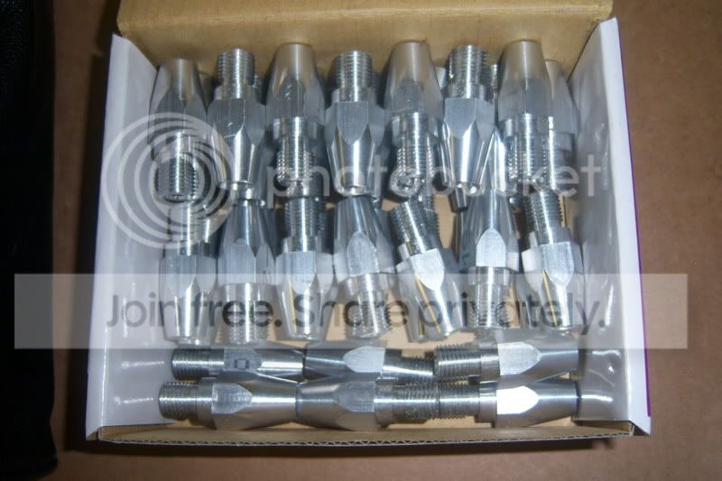

Well, all the machined parts are done and all the parts that had to be ordered and modified are done. Now I'm just waiting on the machined parts to come back from plating and anodizing. Here are a few pictures of some of the anodized parts.
Should have the plated parts back real soon. Then I can start packing up the conversions and send them to their new owners!!!
