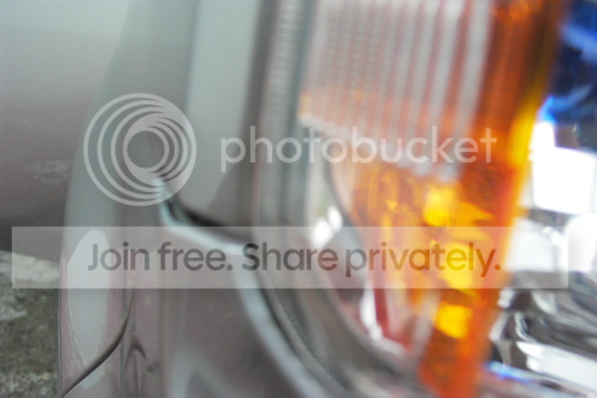

if you know how to fixed please tell me because I try a lot of times

That is a huge Blury pic. I am not sure what your problem is. If you tell us or take a better pic I am sure someone could help you.

sorry for the picture
the problem is the corner of the bumper
is out

It looks like the front bumper on the right side is bulging out at the top where it hits the front quarter. I have no fixes.

The bolts need to be tightened. Warranty fix.

The side of the headlight has a little hook that holds the bumper tight to the fender. Looks like somehow the bumper popped off.
I would say it looks like you need to drop the bumper & put it back on that hook. Its very simple & should only take you about 1/2 hour.
This will tell you how to drop the bumper & also mod the corner lens if you are into that sort of thing. I used this when I put my projectors in.
https://www.scionlife.com/forums/vie...=clear+corners
Good luck & like I said, it isn't hard at all !!!

thank you but I try that and wne I put the middle screw bam is out again and about the warraty I hate to deal with these people in the dealer because they an a exuse bible
like 1,000,000 pages about how to void your warranty(for dummys )

If you ever put different head lights on your box you might also encounter the same problem. I have the helix halos on mine and they don't have the little tab that the stock ones had and my bumper does the same thing but it's so small I don't even notice it anymore.
