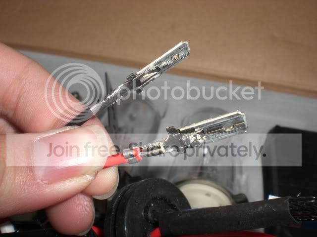

here is what the connector on the HID look like,

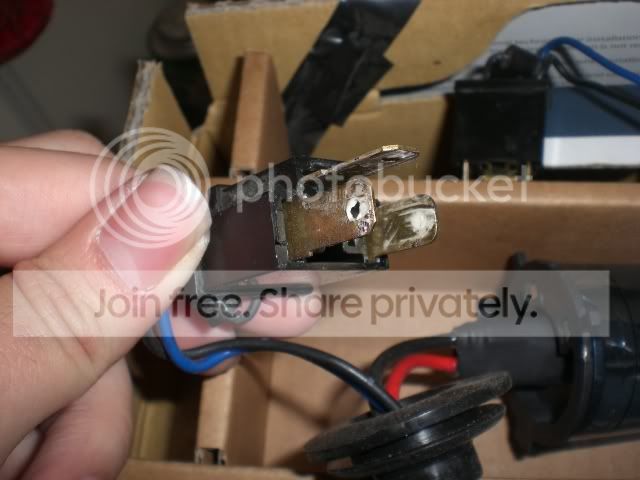

i noticed that the prongs wouldnt be able to connect cause of the blast plastic thing in the way. so i took it off and i was left with this.
so i tried to stick the two prongs into the connector to see if it works, but it didnt, i dont know what else im supposed to do, whether i wired something else wrong, or im supposed to do something else with the prongs

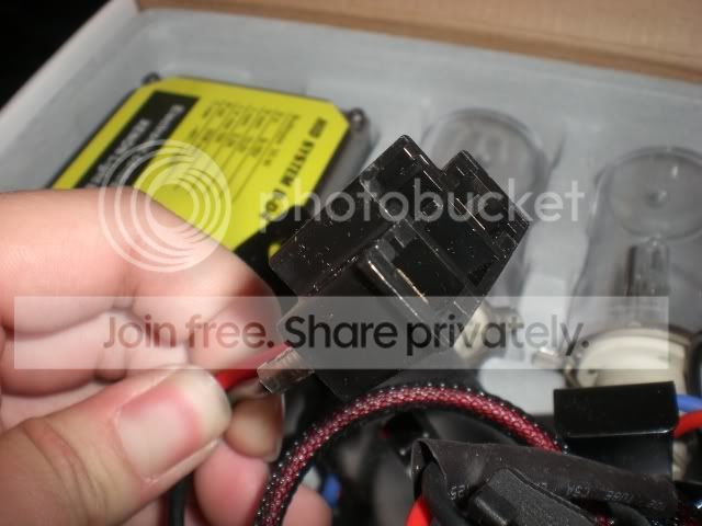

i had a set of HID's before, and this is what the HID prongs are supposed to look like cause they connected to the connectored easily before
what am i supposed to do? im trying to figure out why this HID kit came with only two prongs instead of the usual three that my old HID kit came with. anyhelp is appriecated, i know im a noob at this.
