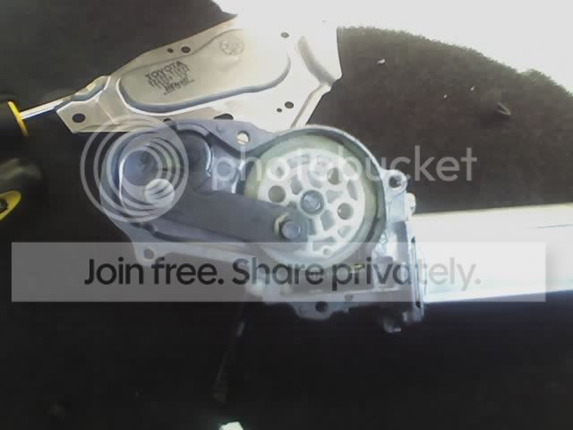

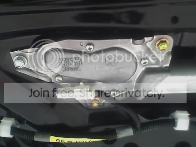

1. With trunk (tailgate) open carefully pull tabs until they pop off.
2. After tabs are removed you will see wiper motor remove 3 bolts holding motor to the rear and undo the one electrical connector

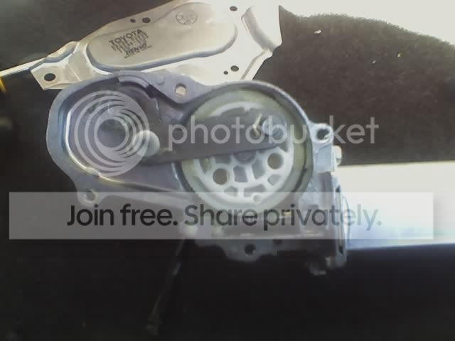

3. With motor removed undo four screws (power tool or alot of torque needed to undo screws). Carefully remove cover until you see gearing inside.
4. Slide silver arm to correct hole to allow the arm to be extended this might be year specific (doing this on an 06) for me it was the top right hole (CAREFUL do not move white gear I did this in the beginning and had to redo everything )
5.Carefully reattach everything but dont bolt down the wiper. Adjust wiper. (I didn't do this and wasted another half hour figuring out why wasn't working properly.

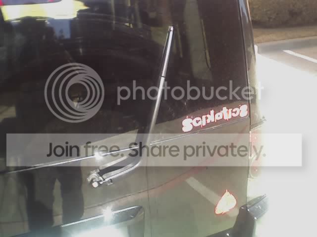

Rickisan, It puts the wiper at a 45 degree angle resting instead of at the bottom for more of a JDM look I just like it cause it is different

The title of this thread is single wiper mod. That usually means there were multiple wipers and you modded it so there was only one. I don't know about you but my xB only has one wiper back there from the factory.
Another question.
Is that mod really JDM??? I think that is hidious. Why have your wiper sticking up like that all the time. Different doesn't always mean good and maybe thats why you don't see many people doing it.
Old Jan 3, 2006 | 08:41 PM
suspended's Avatar
Posts: 332
From: Adult
I have mine like that and think it looks a little better, just up to prefferance...but opinions are like a-holes, everyone has them, most of them stink
