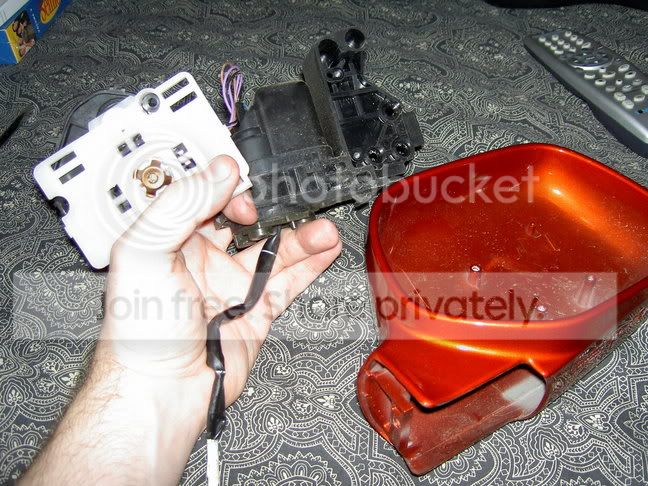

MyBox got a bunch of these in last year and I did a complete walkthrough of an install.
as for a difficulty rating, it is not that bad. (if you can do a stereo, you can do this. it is only two wires.)
this is the guts of it....the only part you'll need
and wiring them to automatically fold with the key/alarm.... is just a lil bit harder.
i love mine. keeps them safe in the hood, garage, tight spaces....

one question... did you retrofit the motors onto the US mirror bases? so that they will be angled US correct.... you'll know what im talkin about if you did... i did mine months ago
i must have gotten lucy with my JDM bases...no angle issues for me.
although i did switch over to the USDM bases after a few months cause one cracked.
did you guys have an issue with one of the screws on the drivers mirror base not having something to screw into???

i did... i took a small screw driver and slid it all the way into the peice on the jdm mirror housing and broke it off at the base... then screwed it onto the motor frame then put one layer of 3m double sticky btween the housing and the broken off tab... it took some of the virbation out of the mirror when driving
Yes, I cut the mounting base from the USDM mirror that holds these screws from the manual folding part and screwed it down to the USDM housing. It is the part that has the places for the metal tabs on the USDM mirror glass to recess into. I was curious if anybody else had issue...

Anyway, question for others that have these and have used the USDM mounts on them. Does one side fold flatter than the other for you? Is that normal or did I screw things up badly? My driver's side doesn't fold quite as flat as my passenger side.
Anyone, anyone........
-Alex
that is normal and is not an easily fixable thing, an attempt at fixing this could ruin your mirror motors. the motor on the driver side is compensating for the JDM base which has more of an angle for Right Hand Drive and the passenger side actually stops itself in the US base. they have automatic relays in them, if you stop one with your hand half way in/out it will stop there, also if you leave them folded out and shut the car off them manually push them in when you turn the car back on it will automatically push them back out, or if you fold them in then shut off the car and push the button to fold them back out it will do the same
-Alex
Totally normal. Fear not good brother!! The passenger (right side in US) mirror is angled in more in it's normal position so the driver can see out of it correctly. So when they fold, the right side comes in more. It's all due to the angles and seating position relative to the mirror. It's the main reason you don't want to use the JDM bases. They are the exact opposite. The left side angles in more because it is actually the passenger side in Japan. You won't be able to adjust them properly to see out of. I can't remember if the manual ones folded in the same amount...guess I never will!!
