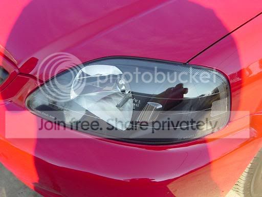

Something like this:
If so, how hard was it...was it worth it...pics?
I think it would look very good, but I wouldn't want to be the first to "try it out"

Ok...I searched for his name and saw some really cool pics. I think I wouldn't paint THAT much of the headlight, just the part that isn't involved in reflection of light. Thanks for the name though...sucks his car was stolen

Yeah, the way it looks in the picture would be perfect.
Would be kind of lame to dim light output.
