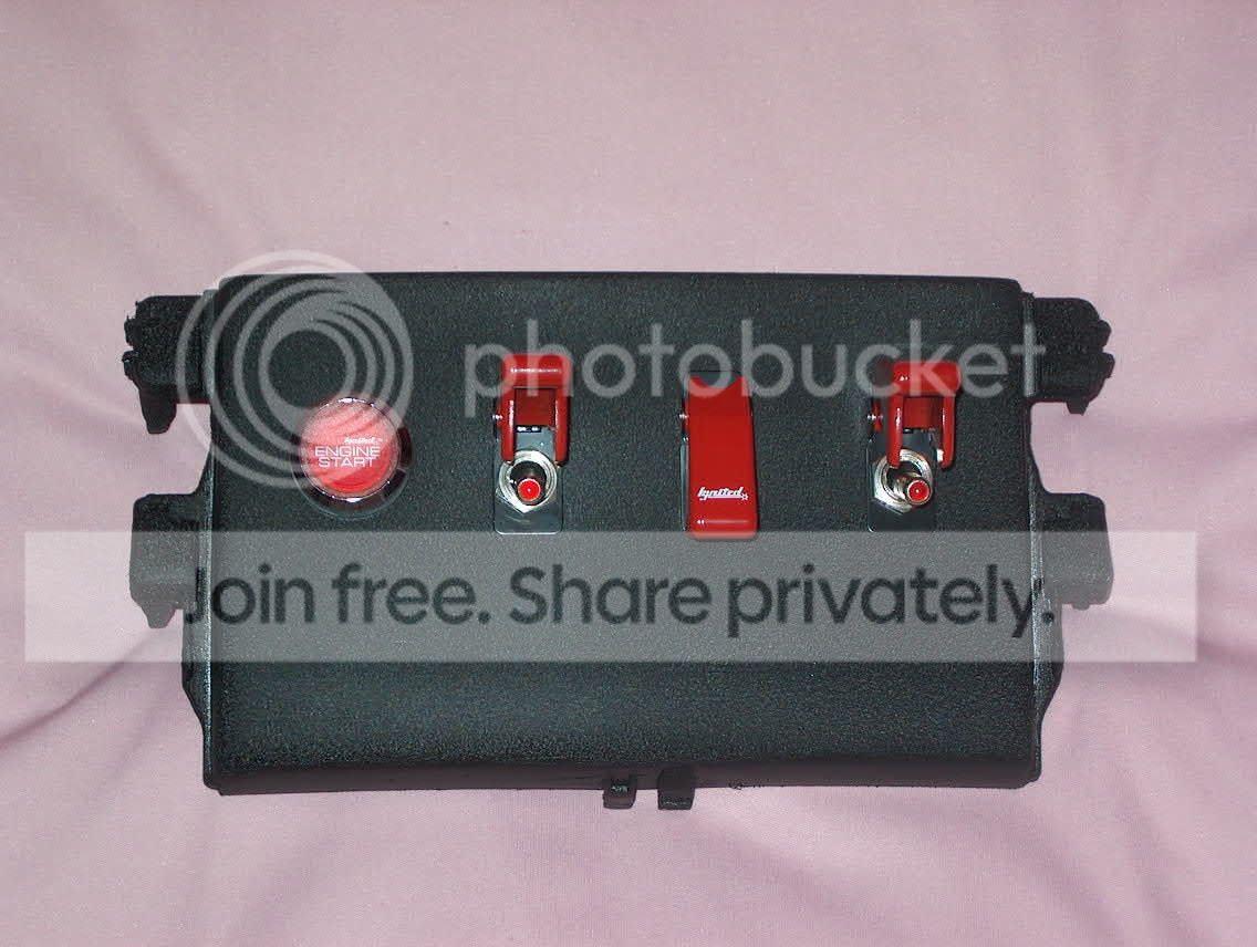

wrinkle paint, if sprayed lightly and evenly enough will closely match the interiors plastic texture. as for the engine bay, that's what it's really made for i think. paint's really strong and durable once you let it cure for a while of course. you can't touch the stuff for at least a day or the wrinkles will just shift on you.
you can get it to look clean if you don't go crazy and spray the hell out of it. the timing on the wait inbetween coats is what will get it looking good, that and light coats. it's hard to get it perfect though.
here's my switch panel in wrinkle paint... matches pretty closely. gives it kind of a plastic texture.
