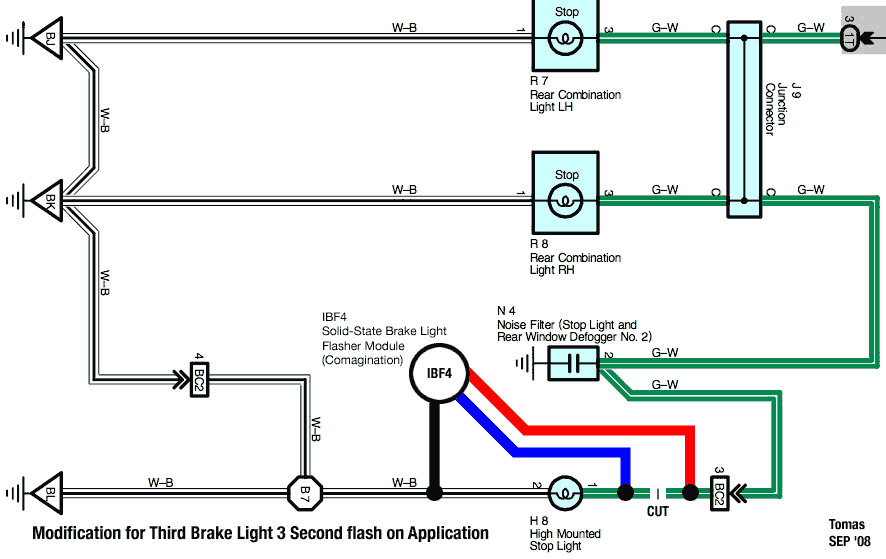

Wiring, in case anyone is interested...

Nice Thomas
Looks good, works with Leds w/out a load resistor too.

I'm surprised it isn't causing problems with the abs and trac. I added an LED bulb to my third eye and everytime I used the cruise it caused lights to come on in the dash. Had to remove the LED bulb to get it back to normal again.
