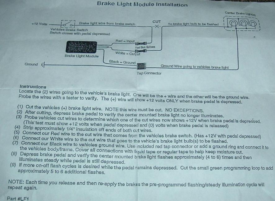

Very nice schematic documentation! Will put this on my mod list, as a to-do!

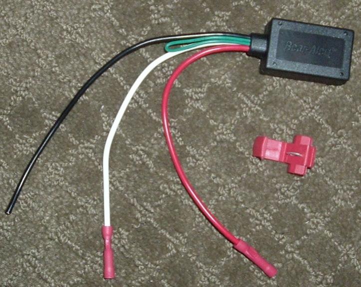

Here is a picture of the one I got.
The green and white wire on the third brake light gets cut for this?
The black and white wire gets tapped?
That's quite a different looking module from the one I got, but except for wire color on the module itself, seems very similar.
As to your connection question, you sound like you have it exactly right. The schematic for connecting it up is on the first page of this thread, you just have to use the right color wires on your module.
Good luck!

It says to cut the green wire on the unit if you want it to blink even more!

Sounds like a decent option.
For my car I just wanted the initial 3 seconds or so of flashing to get the attention of the somnolent Bozo behind me, but sometimes I think a few more flashes might not be that bad an idea.
