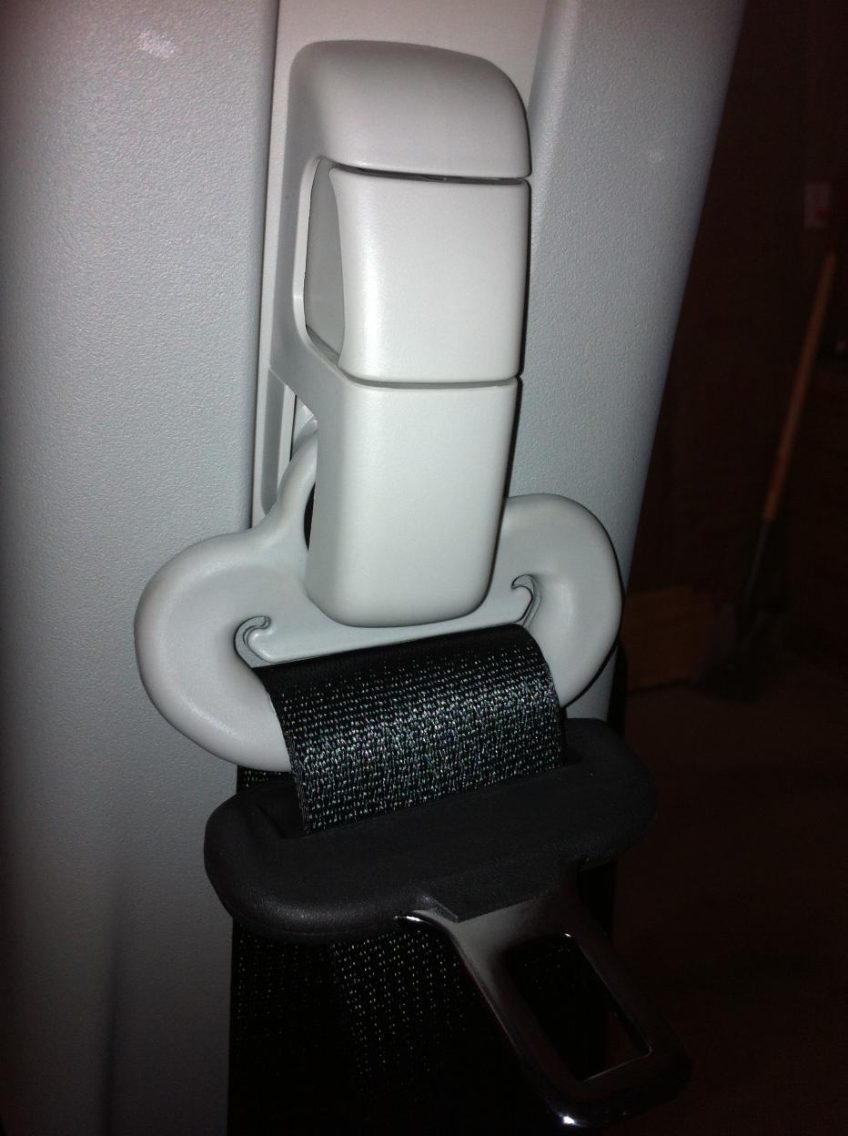

I just bought a 2012 Scion XD, and I am not sure if they changed the design, but I am having a heck of a time trying to figure out how to get the cover off so I can gain access to the bolt that holds the seat belt to the pillar. I have attached a couple of photos that show what it looks like. Anyone know how to go about safely removing it so i can unscrew the bolt?

You posted your question in the xB forum in error.. I think u would have better luck in the xD forum to get an answer.

I seen "Plastic pillar cover removal" and since that was the subject I was seeking information on, I wasnt really paying attention to what forum name it was in. Slipped my mind to check the forum name. My bad. Sorry about that if it caused any trouble or inconvienance to anyone. Since my posting I have found the answer to my question.
