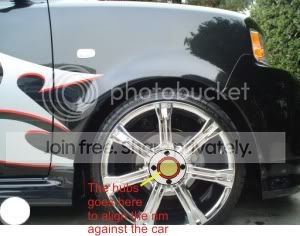

i get it in a local shop/ $15
since every set of wheels have diferent hub sizes
take the car to any local tires shop
Old Dec 17, 2005 | 01:34 PM
jaimecosio's Avatar
Posts: 326
From: extremeautogpx.com

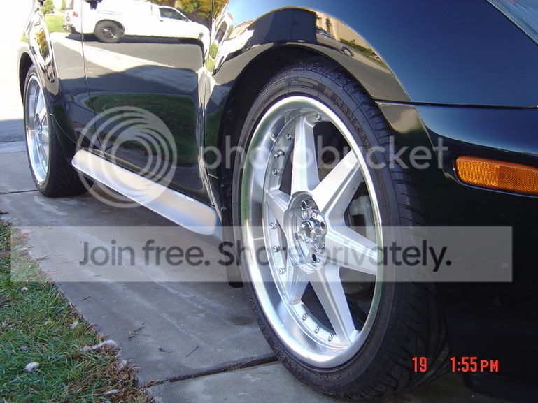

Look what i have:
Old Dec 17, 2005 | 01:41 PM
jaimecosio's Avatar
Posts: 326
maybe yours need alignment

that looks like a wheel & tire package who supplied them ???? Was it online ??
