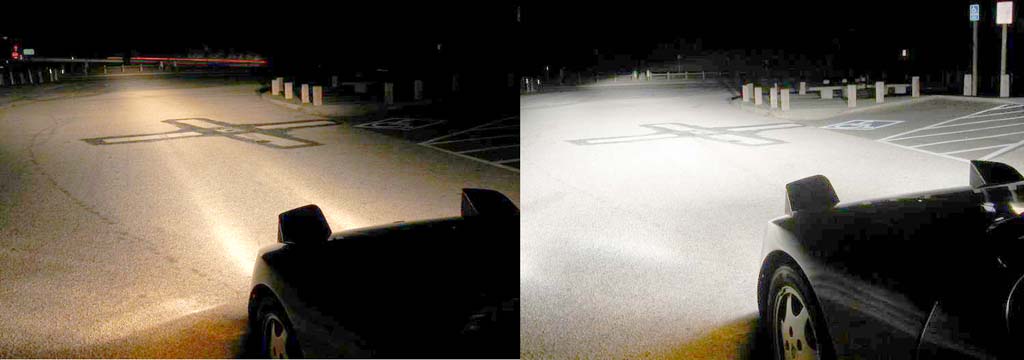

1. Measure voltage at bulb-sockets. Volts = ???
I used to sell headlight upgrade kit for Porsches. Here’s before & after comparison with exact same 55w power consumption.
