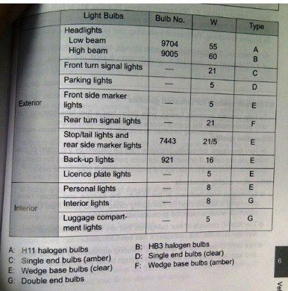

I must be really stupid. what are the 'parking lights' for? I mean whats the purpose? They turn on when low beam is on then why are they called parking lights? I know they also come on when the light switch is turned to first position.
What is the bulb type or number? Owner manual just says 5w Single End Bulb (Clear).

194 wedge base. 168 will also fit.

are you sure? then whats the difference between wedge base and single end? see the attached pic
They're the same thing. I've already replaced my front running/parking bulbs with LED 194 bulbs that are frequently referred to as wedge bulbs depending on the manufacturer, and they fit & work perfectly.
