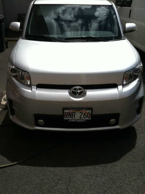

Put on my toyota emblems today

Looks good, i have a New Rumion badge for sale. LMK
Old May 25, 2011 | 08:28 PM
  #67
AlohaDaily's Avatar
Joined: Apr 2011
Posts: 34
From: Honolulu/Las Vegas
Thanks! How much you want for the rumion badge? and is it just the rumion it self or the complete trunk badge?

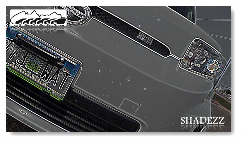

I've had the SE logo from my old gen 3 camry on mine since new....
secret black zip ties
