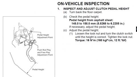

I did it today. I just did a short test drive and i think it feels better, i don't know, may be after a week using it i will be more sure if i like it. I want to share this pictures because i think they where very helpful for me, of course in conjunction with Trevors info.

Guess I never thought about it previously, but the xB2 makes it clear clutch pedal height matters. Whatever info you skii off to make it feel right, the important thing is to have an adjustment that both feels right and works right.
That was the goal of my above procedure and if you get to the same place by some other means, then good for you. Just take your time with the adjusting, a misbehaving clutch is a very much not good thing. I adjusted mine probably three times, each being to make it a little more "correct" than before. Just be careful to preserve a little master cylinder rod free play and keep the clutch pedal over-center spring working for you, and you should be OK. Proper clutch adjustment is very important to a manual shift car, don't take it lightly.

I did this today, and it made a huge difference. I still have some adjusting to do, since my engagement is too close to the floor. But the clutch engagement is a lot better!
I always found it incredibly annoying that my xB's clutch was so much harder to be smooth and consistent with than my MR2 with an HD clutch.
Thanks for the writeup!

I just did this but found the final part of the pedal return catches on the spring. I am thinking the spring needs more grease or it flat spotted after the PO 8 years of driving it that factory way. Any ideas?
Old Jun 5, 2018 | 10:32 PM
  #51
xB1979's Avatar
Joined: Sep 2017
Posts: 5
I figured it out. Too much free play. Adjusted again and works perfect.
Thanks for the write up. What a huge difference it makes! The xB now operates like every other manual transmission I have driven.
