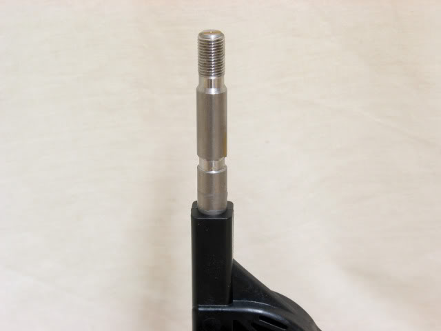

(original)

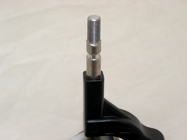

(shortened)

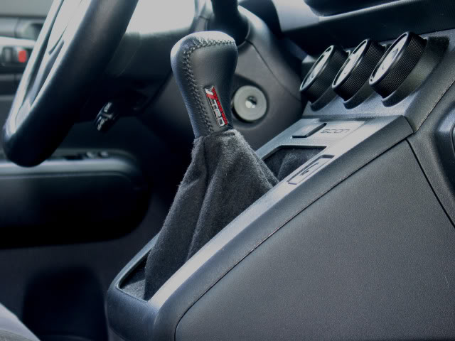

(installed -- OE boot, sorry about the blue cast)
