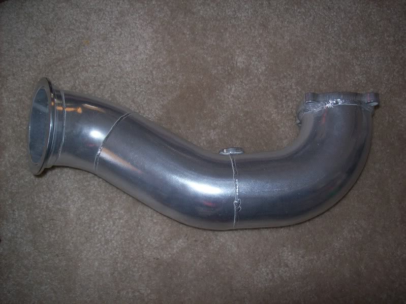

Update: The new 2.5" downpipe is finished. There is about 1/2" clearance between the DP and rad hose. This mani doesn't leave a lot of room for the DP. I don't think 3" is possible with this mani.
Old Oct 6, 2009 | 01:06 PM

wow nice job on the downpipe. That's the way it SHOULD look. Not the freakin crap job the shop i took mine did. Good luck with it and let me know if you need any help

thats a good looking down pipe here is mine its 3 inch
Thanks Homer. I thought your DP looked pretty good except for the dump pipe fitment. But then I'd take good fitment over looks any day. Mine better fit good since I was there during the whole process and even positioned the s-pipe where I wanted it. If it doesn't fit good I have only myself to blame.
Cory's DP is a work of art. Mine is fugly but functional. Too bad Todd doesn't work for CXR. IMO that might be a good combo if Kevin could keep Todd straight.
Be careful about offering to help, I may just take you up on it!
