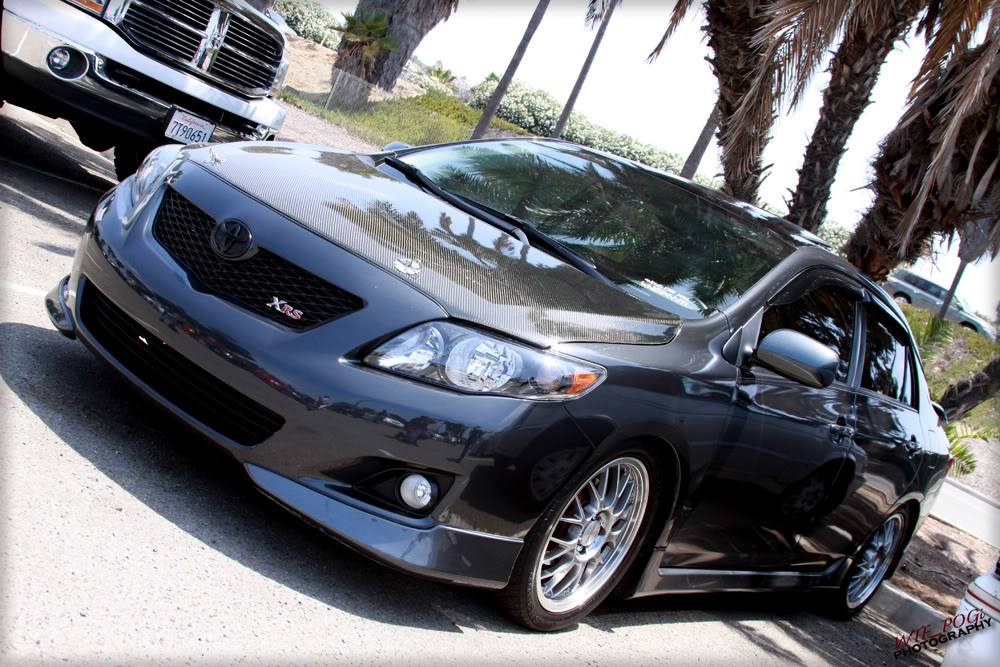

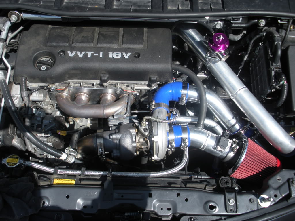

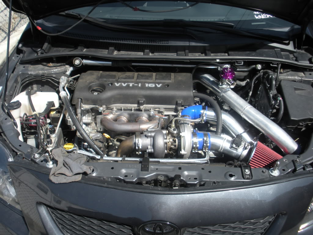

i took my car to rene's shop the r&d guy for cxracing i had told him about the mani crackin on people and he put a l-shape welded on the part where the turbo goes for more support that dint help. here are some pictures of my set up and my aem fic with the boomslag harness. im gonna replace that mani this week and gettin it tune next monday.

I like your Corolla and turbo kit (except for the mani, or course). That's what Toyota should be selling as a performance car, not the weak crap they currently offer. 3000 lbs and 160bhp is a performance car? I know how to adapt the CXR XB kit for a cast mani but not yours. The intake and charge pipes shouldn't be too hard but I think you're gonna end up with an external WG and new DP like I did. The Godspeed mani appears to provide about 1" more clearance for the DP to rad hose but it looks like that won't be enough to keep the int WG. Maybe with a new DP...
I can only think of 2 ways to salvage the CXR mani. One would be to brace the turbo against the block so the mani doesn't hold any of it's weight. The second would be to replace the 16ga tubing with schedule 40 (10ga). I know one guy is doing just that. He found a shop that is going to rebuild the CXR mani with heavier tubing. That should last a lot longer, although cast is still better IMO.
