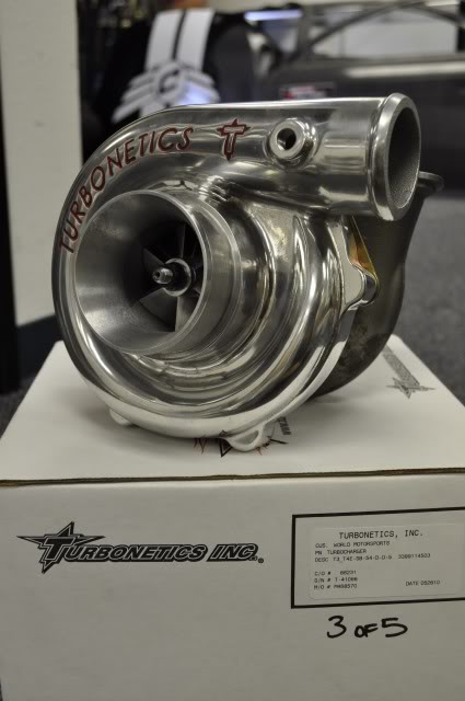

DESCENDANT Kit comes with a lifetime warranty with the exception of the Turbo charger which has a 1 year warranty which is offer thru the Turbonetics.
Turbo is a VBand .55mm Turbonetics TurboCharger that is custom built by Turbonetics for us. Name:  Turbonetics.jpg
