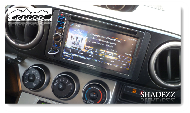

To set you amp right, turn your amp all the way down (gain) and then find the top sound level by turning the volume to 75% of max of the head unit and slowly turn the gain untill you hear it start hissing or distorting.
example on my ddx419
Max volume is 35 (turned mine to 27-28 and adjusted the amp to there. I know now I never should go over 28. My amp is running only at 55% of max gain as full gain is not always the best. 55% gain is were my alpine runs my components all around and is most efficent at that level. Hope this helps with setting yours....
