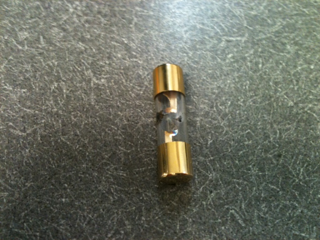

Ok guys, i found the problem. i blew my inline fuse. now my next problem is i have been lookign online and everywhere says that they no longer have it in stock. where do i get one then? its a 5AG50A fuse

Here you go. Would say to call them rather than place online just to make sure they still have them
http://www.sonicelectronix.com/item_...te-AGU50G.html
Old Jul 10, 2012 | 09:05 PM
tikibox's Avatar
Joined: May 2012
Posts: 16
That's a 50 amp fuse. I would seriously be checking all the wiring before putting a new one in. To blow one of them, I would think something is seriously wrong somewhere. 50 amps is enough to weld with. Don't want ya burning your box down...
