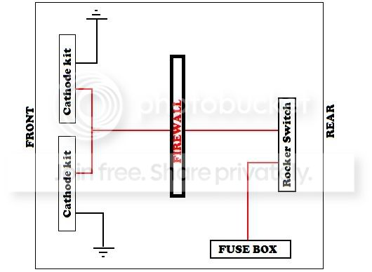

to get access to the fuse box under the steering wheel, there is a rubber grommet above the gas pedal. just poke a hole in it, put a straw through it and that'll make it easier to slide the 18g wire through. removing the underdash peices are pretty self expalantory... just pull
to remove the grille, just pop out the 3 plastic clips and unscrew 2 bolts.
since you're going to be running the wires to the fuse box under the dash you dont need the other fuses.
for the grille lights (cathodes/leds), ground the black wires. connect the red wires from both and run one wire from those to one prong on the rocker switch. then run another wire from the other prong on the switch to the fuse box.
do the same for the leds under the dash.
as for which fuse, it all depends of wether you choose one which is Constant or Switchable power. you can use an electricity tester (those that light up) to find which is which
Here, i made a diagram. If anyone spots a mistake please let me know. i'm pretty sure this is correct though:

THATS SO SICKKKK! THANKS WHIPS!!!!sadly i gotta wait on the cathodes but that well help anyone out. and yess when i get my bulbs i will post pics!
