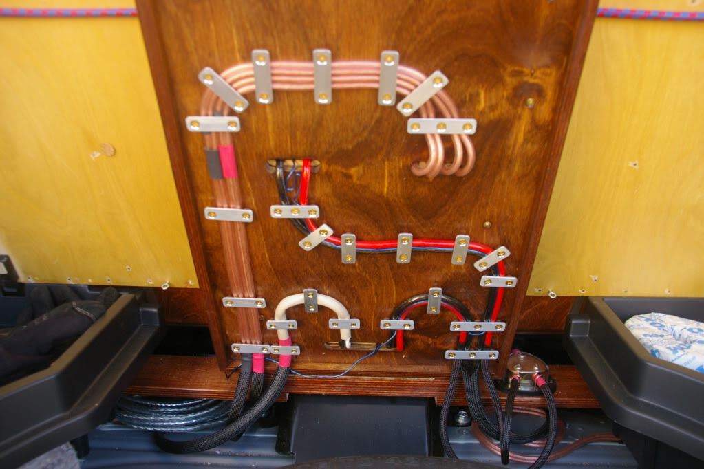

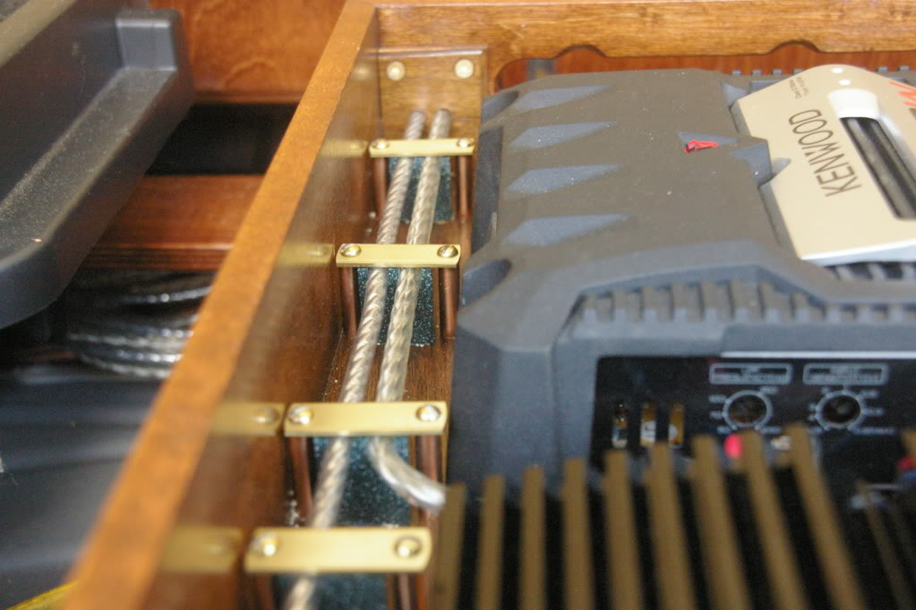

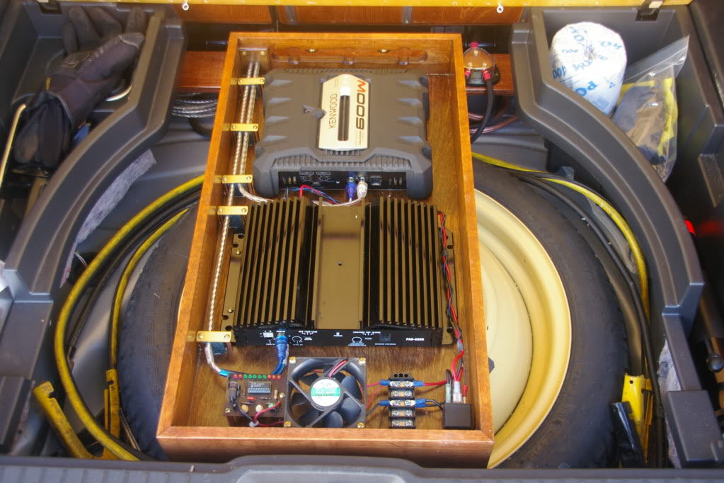

Over the spare amp rack. Since I now had no room for a nice amp install under the seat, I took a cue from a Car Audio magazine article. Again, 1/2" Baltic birch was used for the frame, but 1/4" for the floor. Amps are an old Audiovox ( I think, going to be replaced in the future, see final note) and a Kenwood 300w sub amp. Cooling is done by a box fan venting out the cargo floor. Cable standoffs from Corian, brass plate, brass screws and copper tubing. Under rack cable stays from aluminum and styrene tubes).

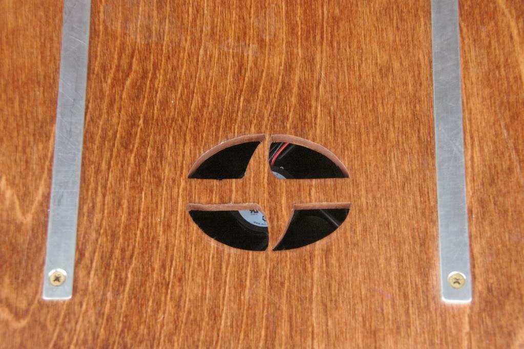

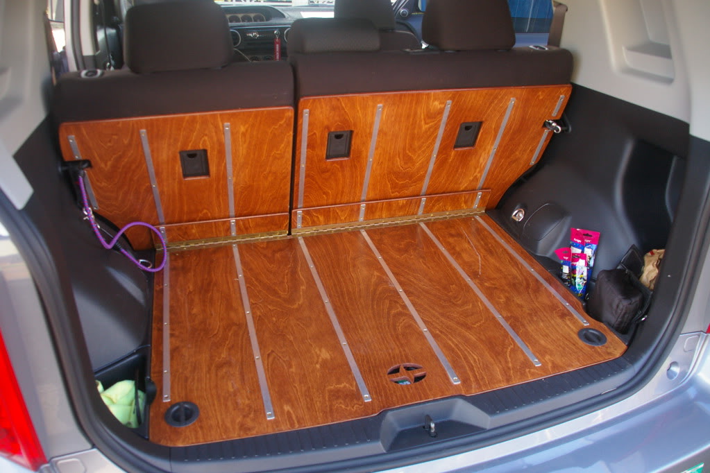

Cargo bed and seat backs. 3/8" Baltic birch, stained, with #6 brass woodscrews countersunk into 1/2" wide aluminum strips. Factory hardware keeps the cargo panel in place. The seat backs are made the same way, put screwed into the sheetmetal frame of the seats, with cutouts for the child seat hardware points.

Looks nice. Whats that thing with the LEDs?

Its a voltmeter from my old system. Uses a LM3919 bargraph meter driver. Reads from 10.5 to 15.5 volts. Figured I had the space for it, so I used it.
