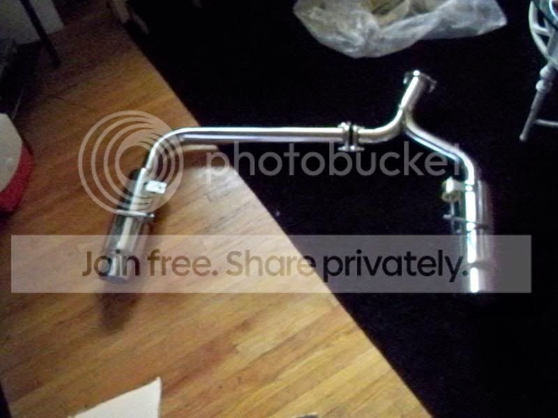

My thinking is to make the rear resonator piping disappear when viewed from the lower rear, so that would be the pipes from the axle area flange rearward to the point where they join the rear resonators. I wasn't planning to paint the pipe from the cat or the resonators and tips. I prefer to keep it to the minimum since it's virtually certain the paint will get chipped over time. I'll be better able to evaluate it when I finally get to look over the exhaust kit.
Just ran across this photo from another forum member who just today received his kit and tried fitting the pipes together. It shows the specific pipes I intend to paint -- stopping at the point of resonator attachment.

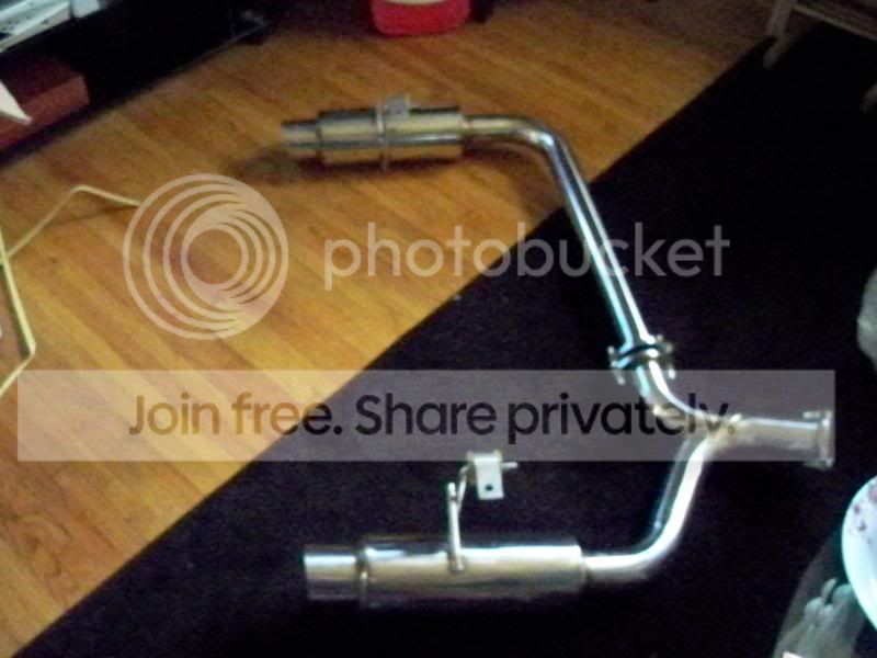

Here are Two more Pic's of My Exhaust i got today... Top shot.
