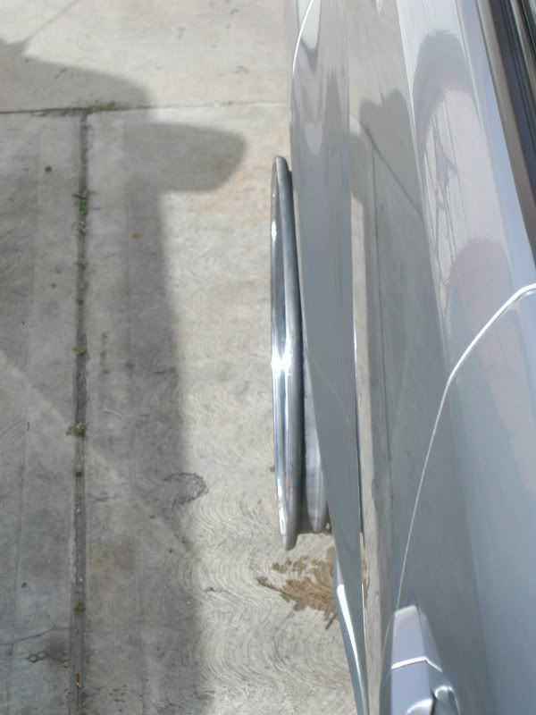

What do you guys think these are stock crown victoria 16x7 wheels do they stick out to much this is the back so im guessing the front will stick out even more

yea the fronts will def stick out more.... but i like the color combo it matched ur B....

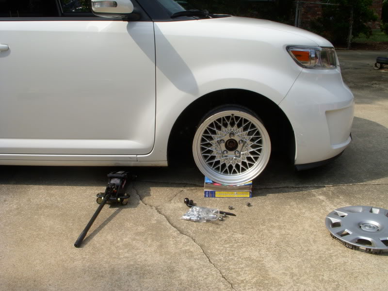

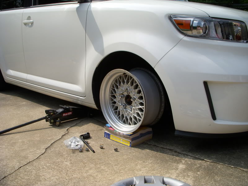

I bought a set of crown vic meshies last year, the front's poke way too much for being a 7'' wide wheel. If they poked the same and was an 8'' wide wheel, it would be easier to find a tire size to stretch on the rim, but the 7'' doesn't really give you an option to stretch.
Also, if I remember correctly, when I test fit the rims on the front, I was having major clearance issue in regards to the rim hitting the caliper...
Here's an idea of how the fronts would look...

Anyways...I took these to Atlanta yesterday to get redrilled...picking them up on Friday, hopefully have them mounted up, with fenders rolled/pulled, and spacer installed on the rear in the next 2-3 weeks, depending on finances...
Specs are 16x9.5'' +38 all around, w/15mm spacer on rear, 205/55/16's all around...

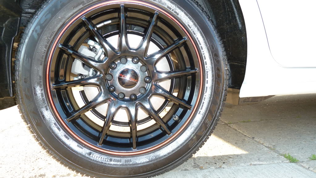

New rims

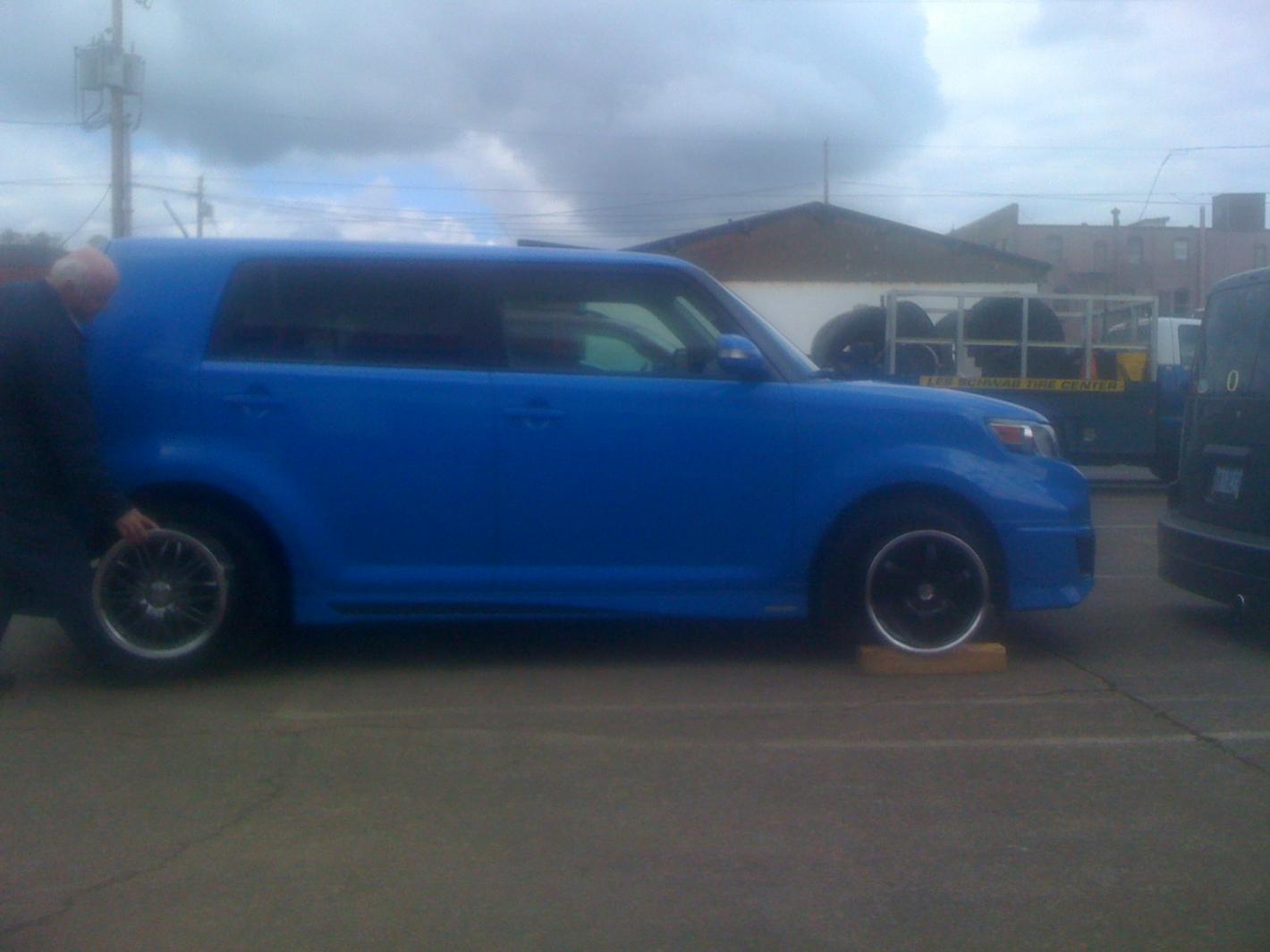

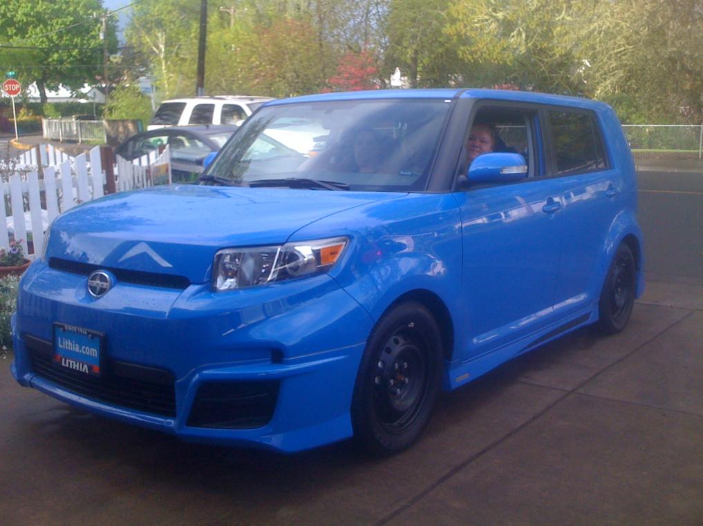

Default Help us decide on Voodoo Blue Wheels
We decided to stick with the stock tires for now, debating on a wheel for our new XB. Should we go Chrome, Silver, black with chrome lip(Right) or Gray with chrome lip(Left)
What would you do?? Suggestions
Car will be lowered on trd spring later this month......

Don't go with chrome; it weighs a lot (lower mpg on a 4-banger), and really only belongs on luxery cars, classic cars, old American muscle cars, or a black xB with a lot of other chrome to compliment it.

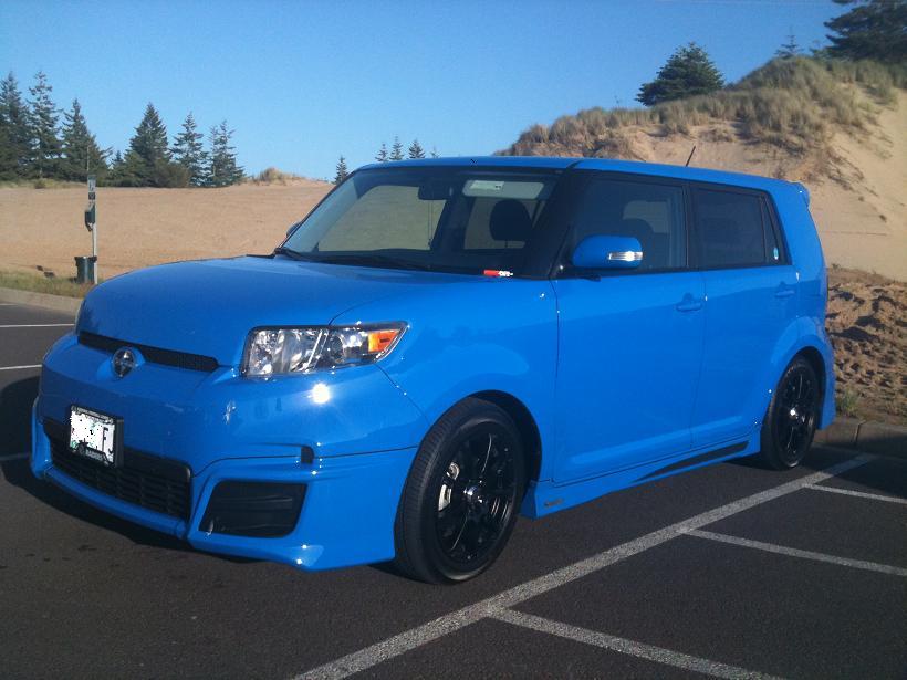

Default Well, here it is
16" Enkei EDR9 wheels with stock rubber, added the wing, rear bumper applique and cargo net. Also lowered on TRD springs.
