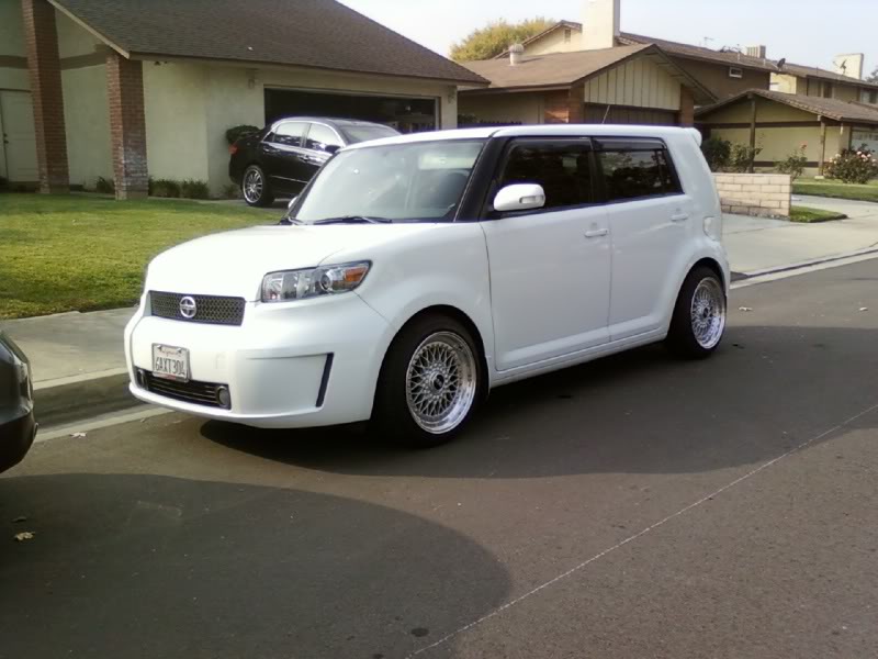

Here's a pic of my xb on 17x9 bbs RS with 20 offset and 215 45 17 nankangs stretched

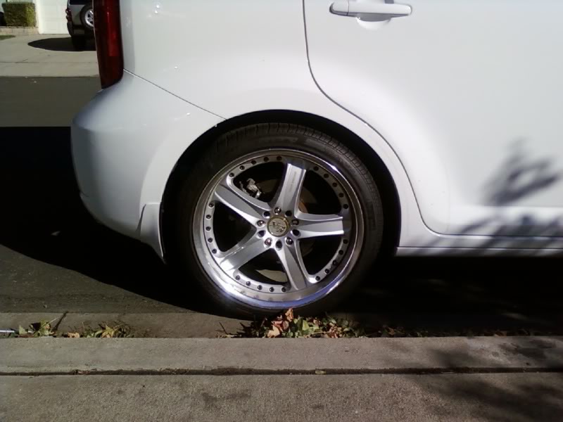

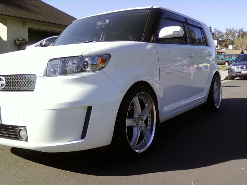

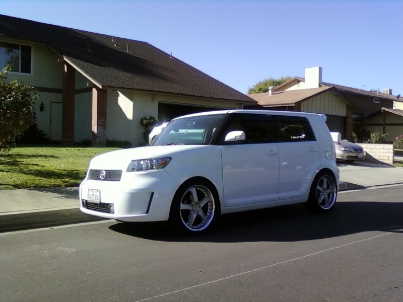

and this one is on volk av3 19x8.5 front 39 offset 245 35 19 michelin fronts
and 19x9.5 rears 39 offset 255 35 19 pirelli

The bbs doesn't rub at all but the volk av3 rubs only when i hit a speedbump on parking lots.
I'am currently on 17 and loving it. The bbs's are pretty light and it makes the car more fun to drive and accellerate a lot faster on the take off and more so the tires are cheaper than those 19's
