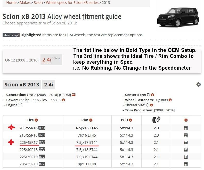

Can I put these on? Bolt pattern and such match and so does offset I think - But worried about tire height? I have only see 225/45 recommended by Tire Rack for 17" wheels. Size comparison wise, they are barely taller.

Originally Posted by blacksheep515
I had a TSX on which I had Konig lightweight wheels (forged or whatever) with 235/45/17 Conti DWS with a lot of life left.
Back to your Original Topic. (Full Disclosure: I Do Not own a xB2 (2008-2015) nor am I a Auto Technician)
According to the Top Chart the only Recommended Ideal Tire/ Wheel Combo for your 2013 xB2 is: 225/45R17 on a 17 x7.5 +44 Rim.
That means IF you go Outside those Specs, you potentially risk Rubbing, Clearance Issues. And throw your Speedometer off.
You can See and Try the Different Setups yourself here
