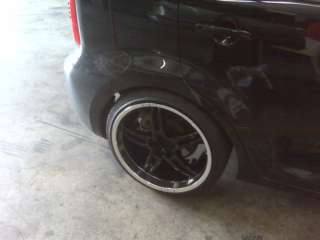

Old Jun 3, 2011 | 06:02 PM
popfizzle's Avatar
Joined: Oct 2009
Posts: 26
From: knoxville tn
this is a zinik (cheap) 19x10 +25 with 235/35/19 on the rear with ksport GT springs.
Fully loaded it will not roll. (meaning 4 people)
with just two it is tucked.
with the fenders rolled and liners removed it rolls just fine under load, but I would NOT recommend this setup without camber - which is happening soon.
you CAN fit a 10 +25 in the rear no problem with some poke (it looks right) but camber would make a big difference and would honestly make it look killer.

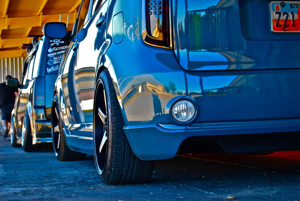

Old Jul 19, 2011 | 06:43 AM
xseveredveganx's Avatar
Utah Scions
Posts: 4,139
From: City of Salt, Utah
We need a fitment thread...
19x9.5 +45 fronts and 19x9.5 +25 rears. Axis Super Hiros, 235/35R19's. Rear fenders are rolled and slightly pulled. Need to do a little more work, rubs just a tad. DF210's.
Photo courtesy of my buddy Kyler. :D
