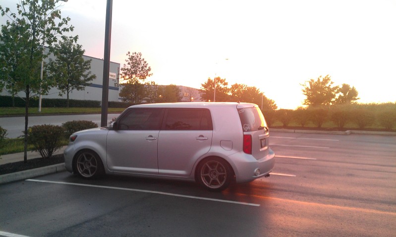

Do you like 6 spoke designs? Mesh?
Here's my xb on 17's for reference. I run kumho ecsta 4x's in 215/45/17.
If your front wheels are dead flush, a set of 15mm spacers in the rear will make the rears flush as well. I would recommend a set of ichiba v2 spacers for safety. I am NOT runng spacers, but it would make the rear perfectly flush if i did.
