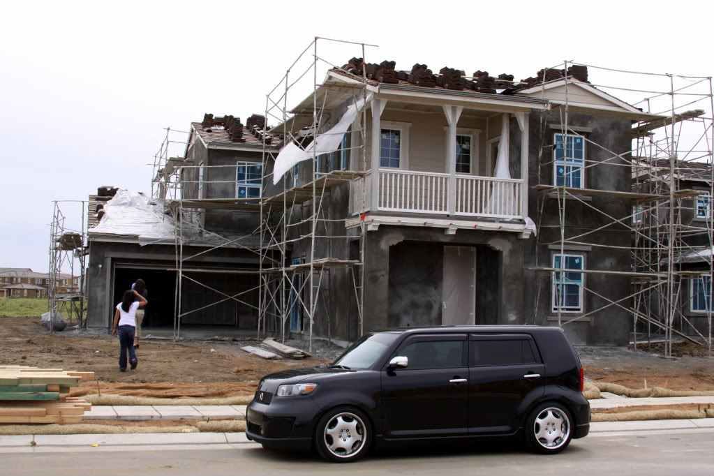

245/45/18s in the rear is going to look way too big. The 225/45 is already about 1" taller than stock and still looks low profile. The 245/45 is going to be over 1.5" taller than stock and just won't look good IMO. I have 18x8s in the front and 18x9s in the rear with BOTH wearing 225/45/18s and it looks fine. People might say the stretch is off, but honestly, you can barely see the stretch on a 225/45 tire on a 9" width rim.
Here's what mine looks like...
NF210s in the front, Tein H Techs in the rears
18x8 et38?, 225/45/18s
18x9 et28, 225/45/18s

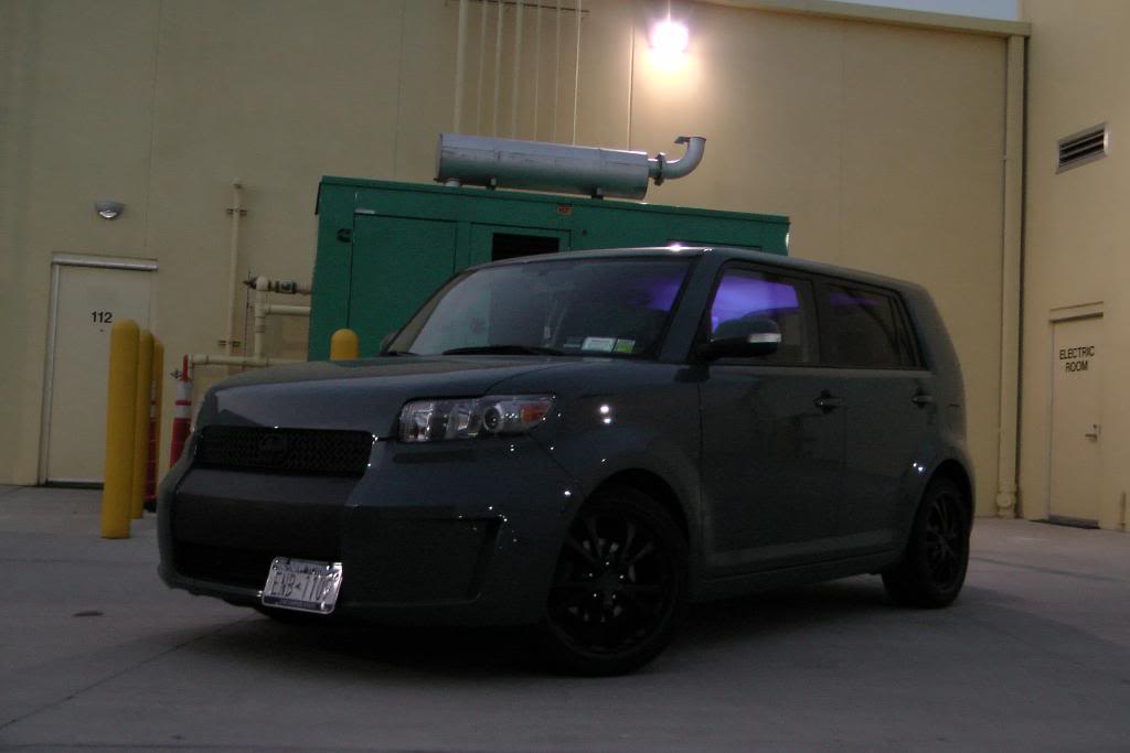

finally put mine on.... took the pics at night so it doesnt show the center cap being HTM as well as it's very dark, but i like the pictures...
Drop, and forjworks taillights soon.
CIONIDE, or anyone for that matter:
possibly before a drop, i want to add spacers, do the spacers require realignment as well?
What can i look into for these?
PICS:
Spacers don't require an alignment, you'll want to do that after the drop.
Spacer thickness that will work without rubbing will depend on wheel offset, tire size, and how far you drop it.
Send me a PM with complete wheel specs including offset, your tire size, and what you plan for the drop, and I'll fill you in on spacer info.

If i only i knew I call these my craigslist rims, all i know is they are 18" and im running 225/45r/18 tires... IMO, either 18x75 or 18x8... i'm going to have to investigate
The size & offset are usually cast into the back of the wheels. Time to climb underneath with a flashlight... good thing you're not dropped yet.

Will look tomorrow. Do you know what spacing Neek has by any chance? Love his.
