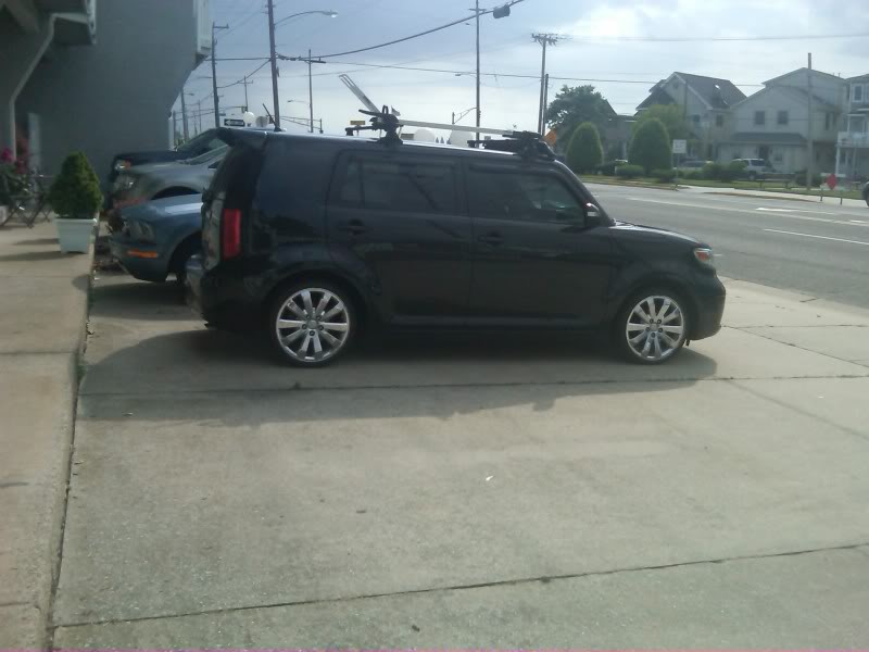

^^ I did something similar back in march, I picked up OEM Ford Edge rims. 18x7.5 Not sure of offset

Those look like the 18" Enkei BRDT wheels that TRDsparks has for the xB2.
http://www.trdsparks.com/displaypart...&parts_id=1519

all the ford wheels look sick on xb2s lol

Big Jim, did you have to modify the calipers at all? By the way, those Edge wheels lool awesome...

Didnt have to modify anything, they just bolted right up. I even got toyota centercaps from ebay, and popped them right in.
