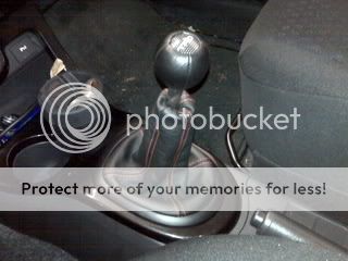

And I just noticed today how lame the boot is. Will have to remedy that as well.
yeah, its lamer than a knit sweater at a company christmas party. i think people on here have been ordering some custom boots from http://www.redlinegoods.com/
The SSK is a must. I may also add bushings in the future... but it is night and day with the TRD SSK alone.
I bought the shift and brake boots from RedlineGoods and I'm very happy with them.
