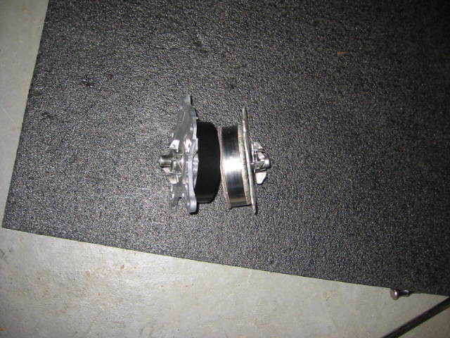

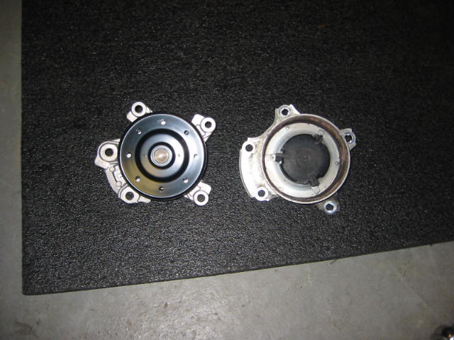

Thanks for the tip. I filtered what I had saved from the tear down and used that with a bit of water to get the level up. Then went to a dealer after work the next day to get the pink Toyota long life coolant. Will be taking the Dex cool back. Talked to a Toyota tech before I poured the Dex cool and he told me some horror stories about how corosive it is. I didn't get to talk to him before I started the job but he told me that no one pulls the engine for this replacement. I picked the coolant up from a different dealer and while I was there I asked one of the service writters how much to do the job and was quoted a "two hundred for the labor". I had not explained what had happened at his competitor. Seems like a fair price to me. I pulled the car in around 1:00 in the afternoon and was cleaned up and closing the door at 6:45. Not bad for never having worked on this car before I figure. Not sure if I can name dealers here. Would love to if I can. Added a couple of pics will try and do a write up soon. The pump view pics show something that really ____ed me off. The new Aisin replacement pump is on the left. The origional Aisin pump is on the right. The quality difference is very plain once you see them side by side. The origional is a stamped steel body where the replacement is a nice beefy alumimun housing the pully center is totaly different and who wants to bet that the bearing is a more stout design.

Mine was growling like a power steering pump. Thats what I thought it was at first. I pulled the front bumper cover, all of the plastic under cover, headlight and window wash unit. Kinda pulled the inner liner back and hooked it behind the tire. The bumper cover is held with little snap in kinda deal at the fenders. Did'nt completly remove alternator just the top bolt. The big bolt in the center of the motor mount does'nt have to come out. In fact the book says to not remove it. Oops to late for me. The mount will come off without pulling it. Once you have the mount out of the way the pump unbolts and comes right out. The Aisin replacement pump is wider overall than the origional - steel plate type anyhow. To get the new on in just drop the motor down a bit and it slides right in. Start a couple bolts and pick the motor back up and you are just about done. The belt needs to be fairly tight. I had to retighten ours after a days drive to work. It squeeled at startup. Seeing the TSB truly adds to my ____edoffedness with Toyota!!! Alldata list's it as SB0048-09R1
