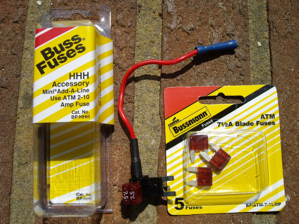

i highly recommend a acc powered fuse under your dash as your power wire source if you dont hook it up behind the head unit. get one of these http://www.toolstation.com/shop/Auto.../sd3263/p53383
(random website i found a pic at, i'd just get one from harbour freight or walmart) and use it to find which slots are constant hot, and which are what i call ign hot, or in this case acc hot. use an acc hot slot for this. when testing slots, the rear contact is the one you should test, the fwd contact in each slot is the ground side. find one that only lights up the tester when you turn the key to acc, and then go buy one of these http://autosfans.com/pico-0956pt-10-...tomer-reviews/ (another ramdom site i picked for the pic, but thats a good price, they run 6-7$ at autozone) and stick a couple low amp fuses in it and attach your amp power on wire to it. hope this helps.

These pics are borrowed from my original under-seat sub post.
I used an add-a-line like cobaltbravo was talking about
and inserted it here:
You can just pull the existing fuse and stick in the add-a-line.
