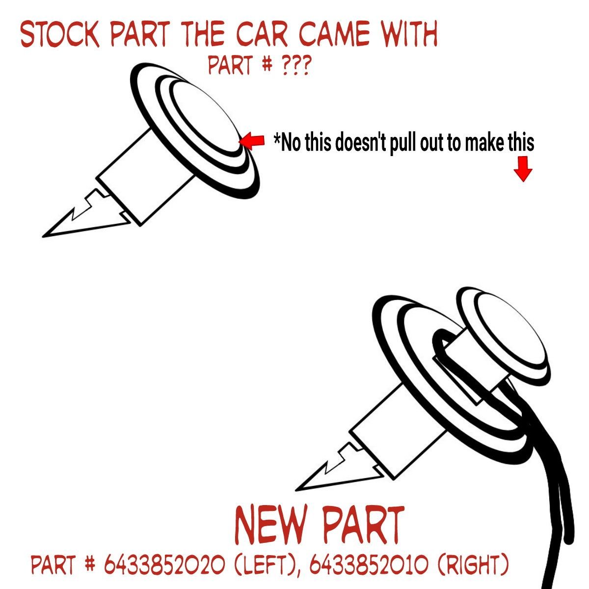

Well, my car is a 2010 Scion xD A/T, the Part Number for the Package Tray is 6433052370C0
And the Part Number for the HOOK, PACKAGE TRAY TRIM GARNISH, RIGHT 6433852010, HOOK, PACKAGE TRAY TRIM GARNISH, LEFT 6433852020
They just pull out though. It seems like they should pull out and stop and then you can loop the elastic onto it.

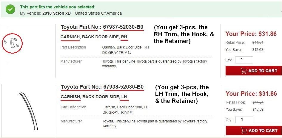

**Disclamer: I Do Not own a xD. I am Not a ASE or Certified Toyota Technician. I Do Not have Specific Installation Instruction or Knowledge on the xD.
But, based on my Research and the Diagrams, I THINK you need a couple of Retainers. They go Behind the Garnish and Extend the Hooks Outward so you can hook them on.
Not knowing what Parts you have or actually Missing, You MAY have to Order the Entire RH and LH Garnish, which Includes All 3-pcs.
MR LUV

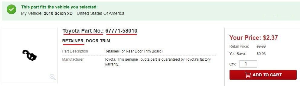

Default SOLVED
Sorry I forgot to take pics of the part but I drew a diagram.
