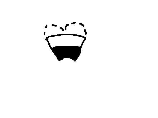

Default Warning light comes on while turning HELP
hey guys i was driving my car around and i noticed that whenever i turn this warning light comes on...i can find a pic of it anywhere online so heres what i could come up with in the little amount of time it comes on

btw it also sometimes comes on when i accelerate

my guess is that your wiper fluid is low. when you take a corner, the fluid goes to either side, and your car will say its low. then once out of the corner, it has just enough in there to make it turn off.

this same thing happens to my brother's eclipse. i think its the wiper fluid. ^ what this guy said. when u turn and accelerate, the fluid goes to one side thinking its empty

haha ok guys thanks...feelin stupid lol
